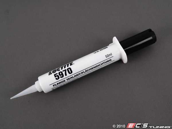

MINI has started using the sealant tube for the Oil pan gasket a little while ago. You can still get the previous pan gasket from other sources.

Gen 1 pan is different (cast aluminum) and would need a gasket. Gen 2 cars have a stamped metal pan and only need liquid sealer.

MINI has gone to the sealant like I said above on the Gen 2 pan. Even though the regular gasket ( paper type ) is available aftermarket.
On the Gen 1 MINI pan , MINI has the regular rubber gasket w/ metal washers.

So canyou just use a black rtv sealant? I have a tube because of my old toyota. 2008 justa. Dealer says gasket is leaking, 630 dollars to replace.

From the link above thats the sealant from MINI.
