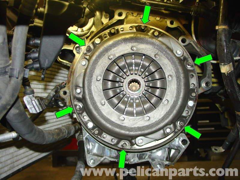

If you determine your clutch is bad, we have some really great clutch super kits HERE that you should consider. If you are spending the time and effort to do this job, you might as well make sure that you are replacing and fixing every piece that might need attention, while you have access to it. That's where those kits come in handy as they have everything you'll need while you're in there for the job. We also have a great tech article on our site under MINI > Tech Info (tab at top) > Transmission & Axles > Clutch Replacement that can help you tackle this job yourself. Let me know if you have any questions.

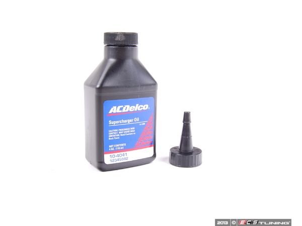

That's the plan. I figure now is a perfectly good time to do a lot of stuff that's it tranny related but is accessible. I'm thinking of servicing the supercharger and am on the fence about the starter. Opinions?

Doing a clutch doesn't really make getting at the supercharger any easier. The one same step is taking off the bumper, otherwise not much more. Unless you take the radiator out too I guess, but I left mine on. Most of the intake stays on, intercooler stays on, belt stays on.

+1 , goo time to go to a valeo conversion kit, also listed are the guide tube and seal that will need replaced. Our kit is free ship also.
https://www.northamericanmotoring.co...ss-clutch.html
Supercharger oil : & DIY linked
https://www.northamericanmotoring.co...arger-oil.html

Unless your starter is exhibiting signs of it going bad, I'd spend the money on doing the essentials that are accessible while you're in there. You could, however, do it as a preventative measure if you feel like it. It's always a good idea to replace the rear main seal on the engine at the same time and also replace the throw-out bearing, flywheel bolts and etc. You should also replace the clutch release fork and the master cylinder/slave cylinder at the same time for added insurance. All of these are included in our clutch super kits. Also, use this site HERE to help you find an indy shop for the future.
