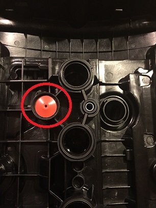

Crud, I jinxed myself. Had the CCV in our MINI fail last night, but since I replied to your post I did the check on mine. Here is my video
I found the red diaphragm missing on the inside of the cover. Here it is on the new cover. That means its in the engine somewhere...I hope it is deteriorated enough that it doesn't clog up some oil passages.

Wow, mine does this too. I feel that an expensive fix is coming. How much did it cost you to fix it and what parts were needed?

My experience with BMW engines that make that noise in the 2nd video it is air being sucked in through the crankshaft seal.
Its easy enough to pull the valve cover and look for the red diaphragm. Mine was missing! I pulled the oil pan looking for it and fond it wedged in the oil pump sprocket cover. When I took a close look at it is was soft and mushy.

The rubber diaphragm gets soft over time from the oil and fails to make an airtight seal, or in my case just falls out.

Pull your valve cover off and inspect the diaphragm on the underside and see if it is form/tight or if it has fallen out. From looking at mine I didn't see any gunk inside the passages, so doubt cleaning would do anything.

Pulled the valve cover and unfortunately no smoking gun... On the good side the rubber diaphragm seemed to be in good shape. I checked the other 2 flappers i could see in the vent tubes and they seem to be working fine.
Any ideas? Try and clean it out, or bite the bullet and buy a new cover? I'm thinking the latter....
