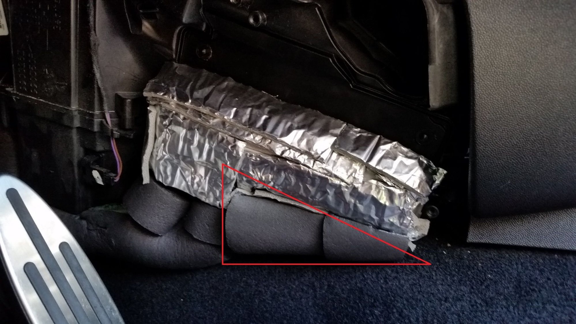

Pull the plastic cover off on the side of the air mixer box by releasing the screws pictured under the red circles and sliding the cover away from the firewall and down to release the firewall clip shown under the red square.
With the cover off you will see this
The heat exchanger runs full time so the pipes you see heat up to coolant temp of the motor. There is little to no insulation on the plastic cover so you can easily experience hot foot syndrome. If it is really cold out you might enjoy it but in the Florida heat that area can get quite toasty. Notice the red circle above the pedal where the heat has actually toasted the wiring loom wrap. The loom in that area runs right under the heater pipe and on my 2013 Roadster the insulation wrap had fallen away and the wires were sitting right on the metal pipe.
The idea is to insulate the exposed metal to prevent heat radiation from cooking your foot. I used foil backed foam tape and armacel 1/2 pipe insulation both bought at home depot plumbing department.
I started by covering the entire exposed heater core with one layer of foam tape. Then a second layer of tape on upper and lower portions. I left only one layer of tape on the end cap so the plastic cover would still fit. The lower pipes were insulated with one piece of pipe tubing around both pipes. I used a plastic trim tool to compress the foam into position around the pipes. No rocket science here if you mess up just cut some more and try again there was enough material to do 5 or six cars.
I also reached behind the heater box and put insulation between the pipes and the wiring harness to protect it.
The last thing I did was to place pipe insulation under the gaps to keep the hot air from the rest of the heater box flowing down into the footwell.
Make sure you keep the lower screw area clear.
Replace the panel cover and you are done. I measured the area after driving and only showed a 10 degree rise in temp compared to the rest of the footwell.

Very nice writeup! That should help the rest of us when we get tired of hot feet in the summer.
