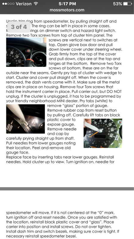

Read it here:
Attached Thumbnails Can i remove my speedo w/o recoding?-image-1612555733.jpg

They are describing a procedure that includes turning on the ignition. No, I wouldn't turn on the ignition while the speedo is disconnected. It is no problem to disconnect and reconnect the speedo if you don't turn on the ignition during the process. If you want to be completely safe, disconnect the battery before you work on anything electrical.
excellent, well I'll give it a try thanks a lot.
