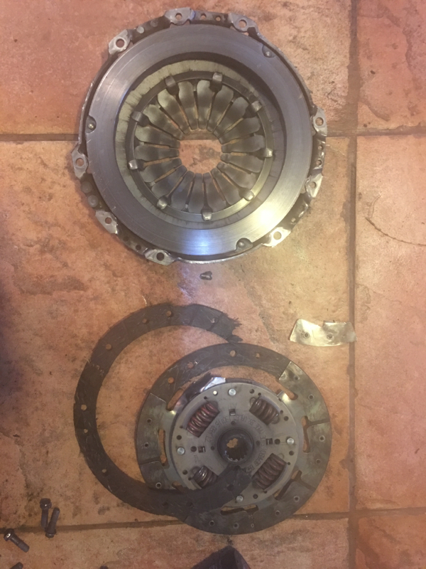

Has anyone experience this with a valeo clutch. This clutch kit has less than 4 month installed. 3 trackdays the rest is daily car. The disk broke down and nobody can tell me why this happened

Are you sure it was properly installed?

Yes. It was properly installed. With the centering tool. It was working fine until that happened

I was more curious about whether the front/back orientation was correct.

Yes the flat side of the disk was mounted to the flywheel side.

Then its a mystery!

Before taking it out. You can see that the long part of the disk is to the pressure plate side.

Never seen that on a MINI. Been using Valeo for a while now.
Wonder if the disc was damaged in shipping on the press rivets, then missed on install ?
The boxes can get smoothed pretty easy.

Never seen that on a MINI. Been using Valeo for a while now. Wonder if the disc was damaged in shipping on the press rivets, then missed on install ? The boxes can get smoothed pretty easy.
I bought it from your site.

Please contact our customer service and let them know what happened, so we can send this onto Valeo. 1.800.924.5172 or customerservice@ecstuning.com
Possible it could have been damaged somehow in shipping, do you remember the box being crushed or anything?
