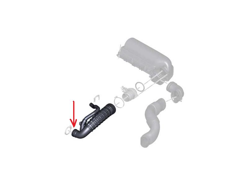

I need to locate the name of a part on my air intake system. It's on the tube that goes from the air filter housing to the turbo. It's the rubber bushing/seal that goes in the end of the tube where it fits over the turbo. Any help in locating either the name of the part or the part itself would be appreciated. Thanks

Found a picture to help show where the part is that I'm looking for. It's the rubber seal that fits into this end of the tube. Thanks

If the part doesn't show up on the RealOEM illustrated parts breakdown site, it probably isn't sold separately, and you either gotta buy the whole tube, or go find an equivalent seal at your local hardware store.
Or, maybe it's time to invest in a complete CAI system that includes this tube.

The seal , Its comes with the intake tube, not a separate part: At the end near the turbo
#10 rib type. Rubber Boot N14 Engine Cooper S . 13717555784
http://www.ecstuning.com/Search/SiteSearch/13717555784/
# 12 Hose Clamp ( rubber boot ( intake ) connection to turbo. Part # 13717577548
http://www.ecstuning.com/Search/SiteSearch/13717577548/ES35254/
Get the clamp also , they old clamps can loose clamping force for being on and off all the time.
You don't want it sliding off and anything damaging / sucked into the turbo.

Thanks. Found a used one.

Welcome, make sure the inner gasket is ok and not split.

You talking about the rubber part? It's like new. That was my old problem. It was torn in half.

yep, that seal gasket
