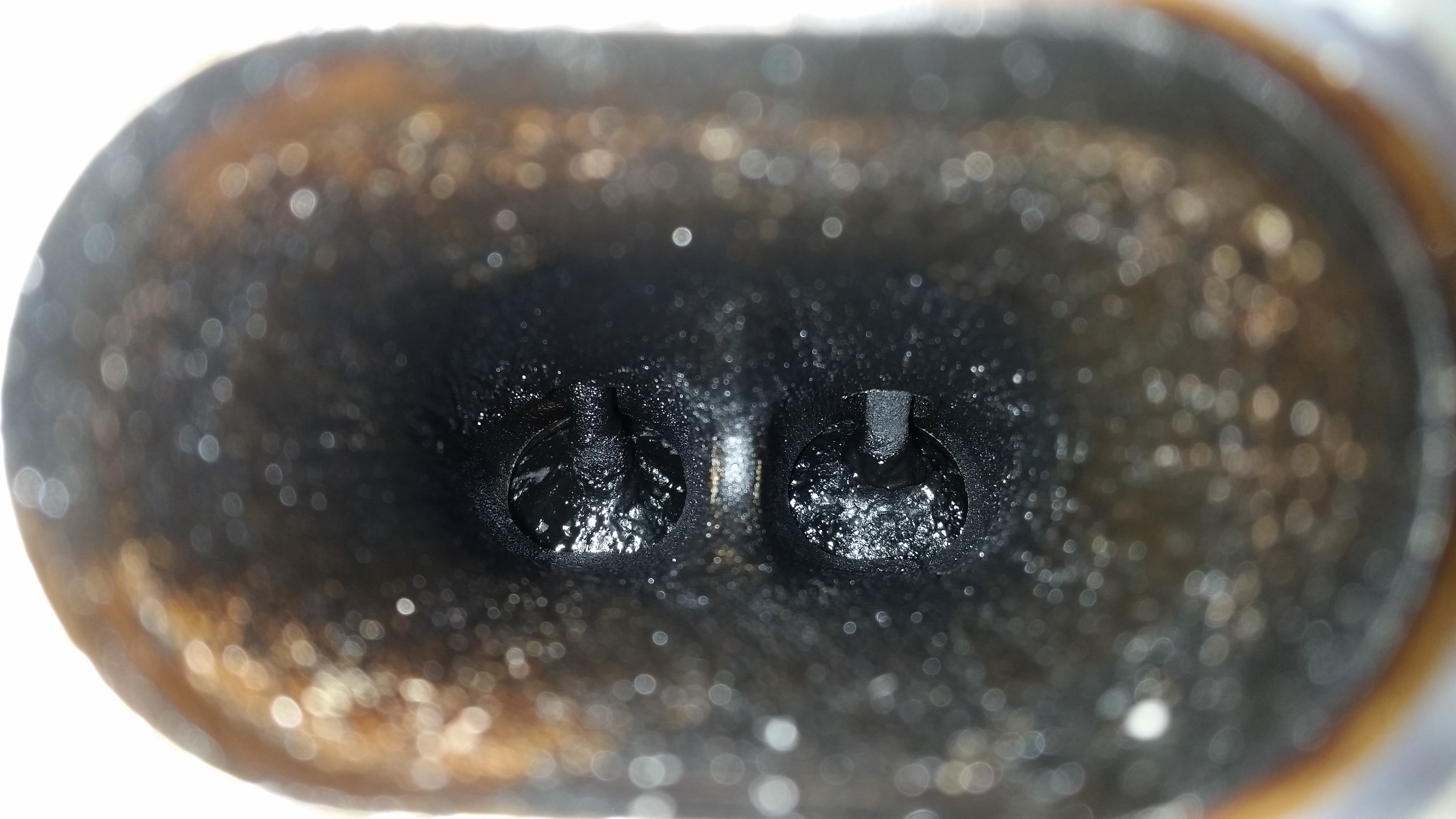

Hay before we start with looking at the pictures there's something you should know, my MCS consumes half a quart (1/2) of oil every 1000-1500 miles which isn't that bad as the first picture shows. Less consumption highway driving which is 75% percent of my driving.
The first picture is the before picture the mechanic took of the worst cylinder #1 (left to right). His cameras screen was to small so he loaded it to the computer and I took a picture of the computer screen. I took these other four pictures today myself, the second picture is the cylinder #1. They look like the same cylinder, I'm seeing the same picture just 15,000 miles later. The third picture is cylinder #2, forth picture is cylinder #3 and the fifth picture is cylinder #4. Looks like someone was using dentist tools.
I don't know about you but it's my belief that cylinder #1 was never cleaned as well as cylinder #2, the last two were done in my opinion. I'm interested in what you believe cause I think it was a half a** job at best!

You know bg44k does NOTHING with a DI motor?! Well, not quite...but it cannot clean the intake valves...the fuel (with the bg44k)is getting injected into the cylinders directly from the injectors screwed into the top of the head just like a sparkplug...
Bet you driving style just needs a carbon cleaning every 20,000 miles or so...Would not be unheard of...

Each set of valves will accumulate carbon at different rates due to the intake tract not being ideal.

cerenkov do you believe the Mini dealer cleaned my valves in the first place? The first picture is before the walnut blasting at 47,000 miles, the before doesn't look bad at all. After the walnut blast at 47,000 miles they look 10 time worse after only 15,000 miles. Something doesn't add up here burning half a quart of oil 1000-1500 miles is good compared to other MCS owners! More than one Service Writer stated my valves didn't look that bad especially compared to other owner's Mini's.

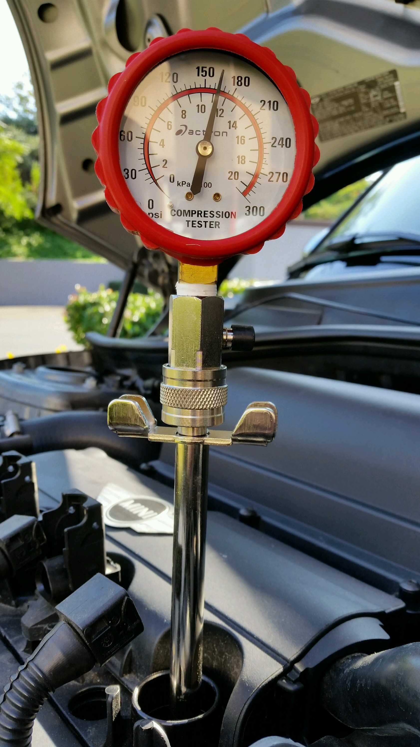

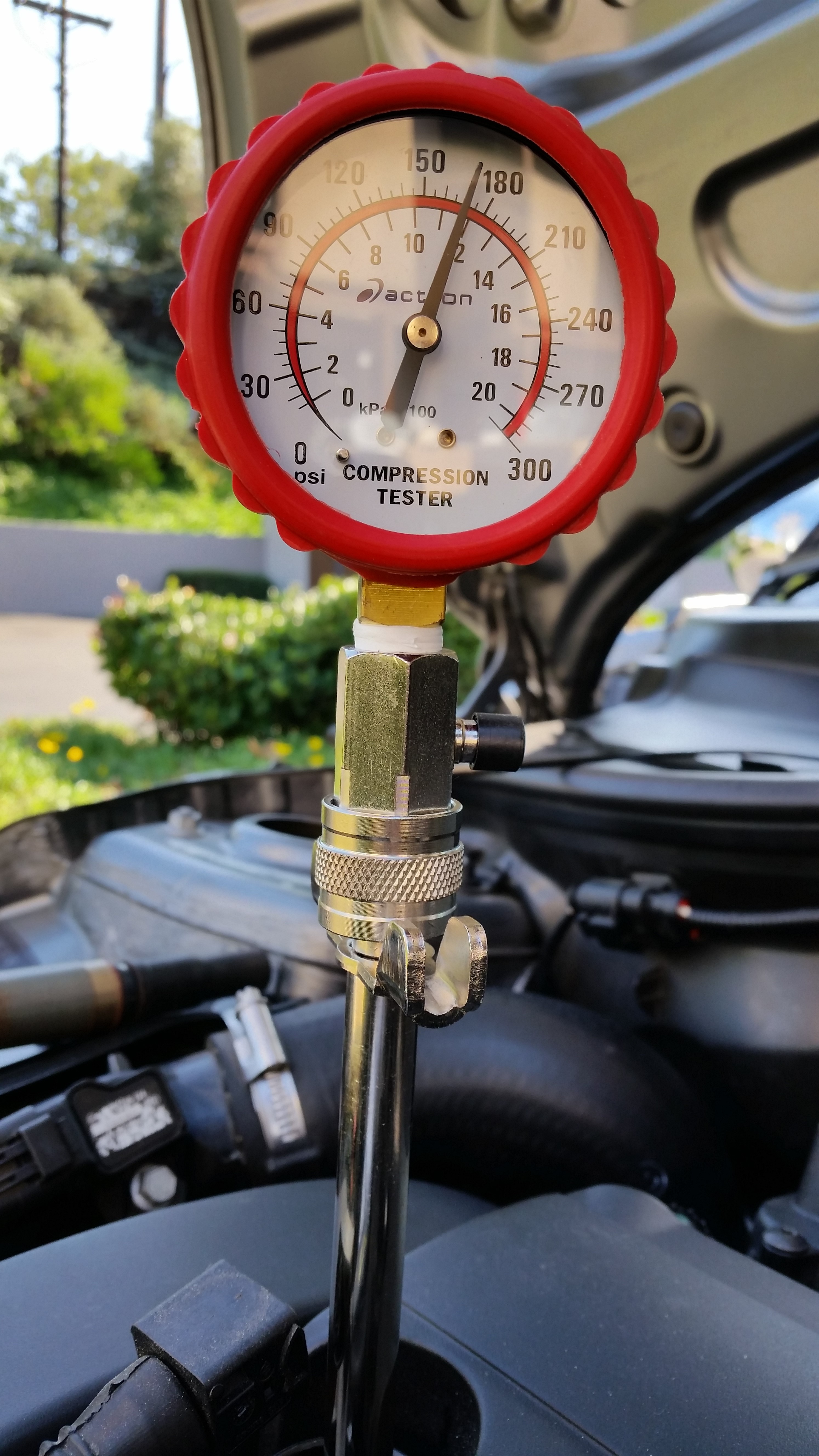

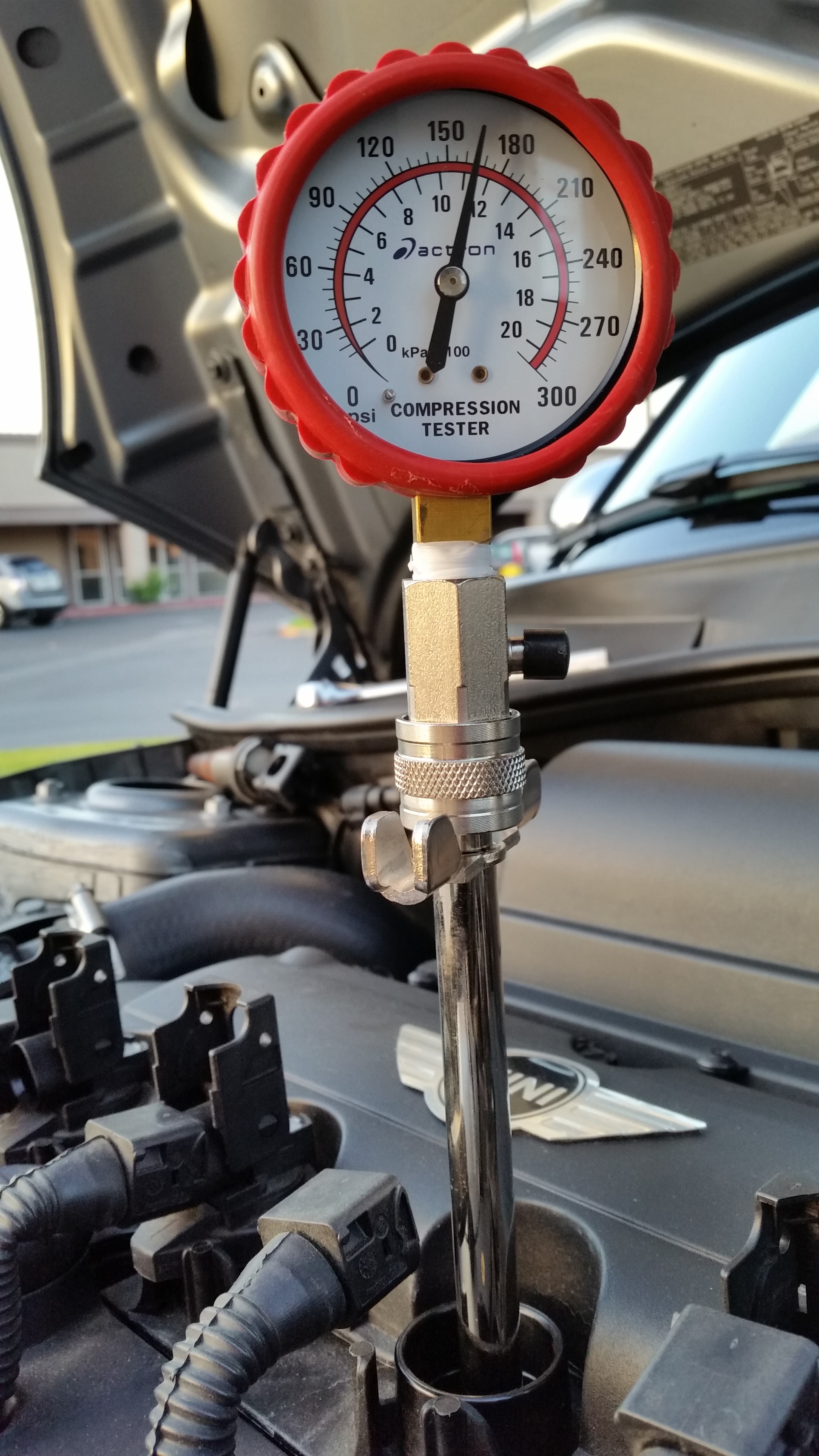

u sure u need walnut blast instead of compression/ leakdown test?
my engine was indeed so bad that it was replaced soon after that. (actually half of the bits of my car was replaced in that couple months lol)

Nope already performed a compression test, hot vs cold yielded the same numbers, dry test only. Tigger2011 rebuild his engine from top to bottom with forged rods, pistons and after driving 500 miles on conventional oil to break-in the engine his dry compression test results were 170, 170, 170 and 168. It just shows you how well my cylinders, rings and valves seal. That's why this is so hard for me to understand, with readings like mine it's hard to believe the carbon deposits on my valves!

Looks like when the mechanic hit it with the media, they might have not worked the cylinder 1 as much as the others. Like its was the first one done. I have seen where the walnut hits it and boom its clean, and I have seen where the media needs to work it a couple times as the build up is very bad and caked.
You could always DIY and then make sure its done right. Or get an indy shop to do it again. Or complain to the MINI dealership. Also driving habits seem to affect the carbon build up also. Lots of short trips and low miles seem to have the build up more.

None of those pics look completely out of whack--even for 15k miles. Here's what you do: get a professional WS cleaning from a reputable shop with the correct equipment (we use factory tools and charge $349 for the job). Get your oil changed and see how your engine runs and consumes oil.
