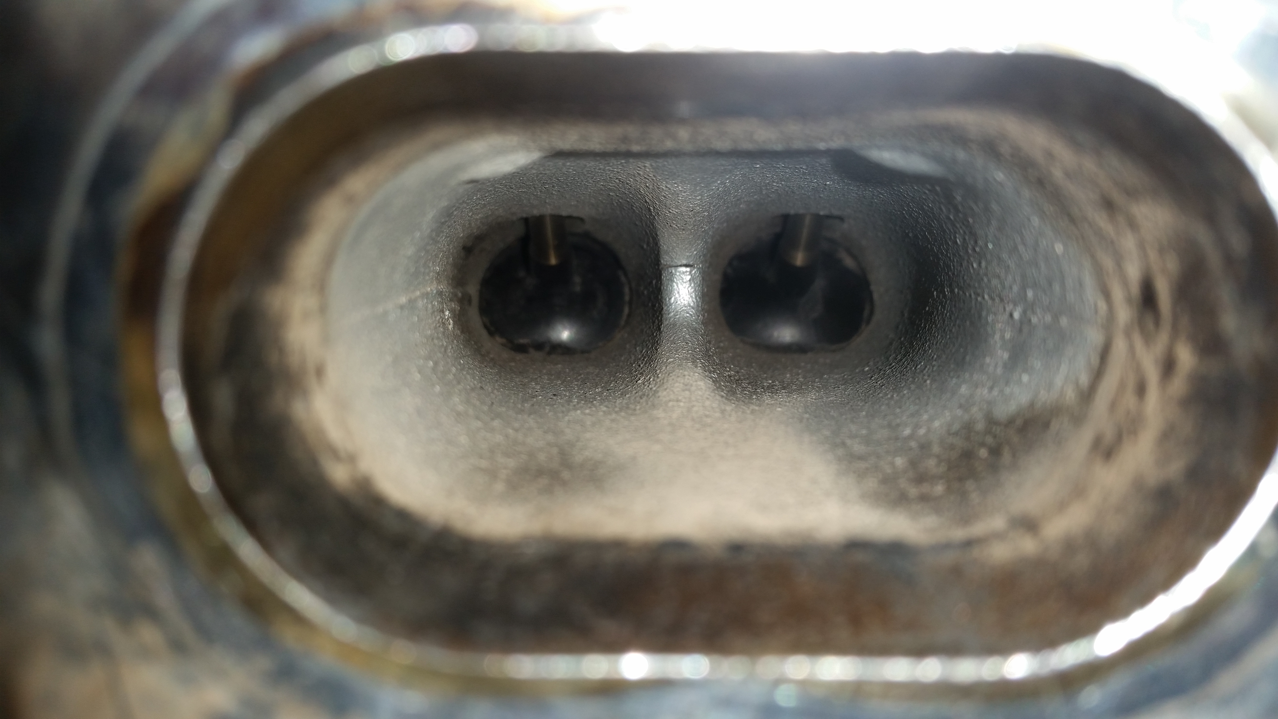

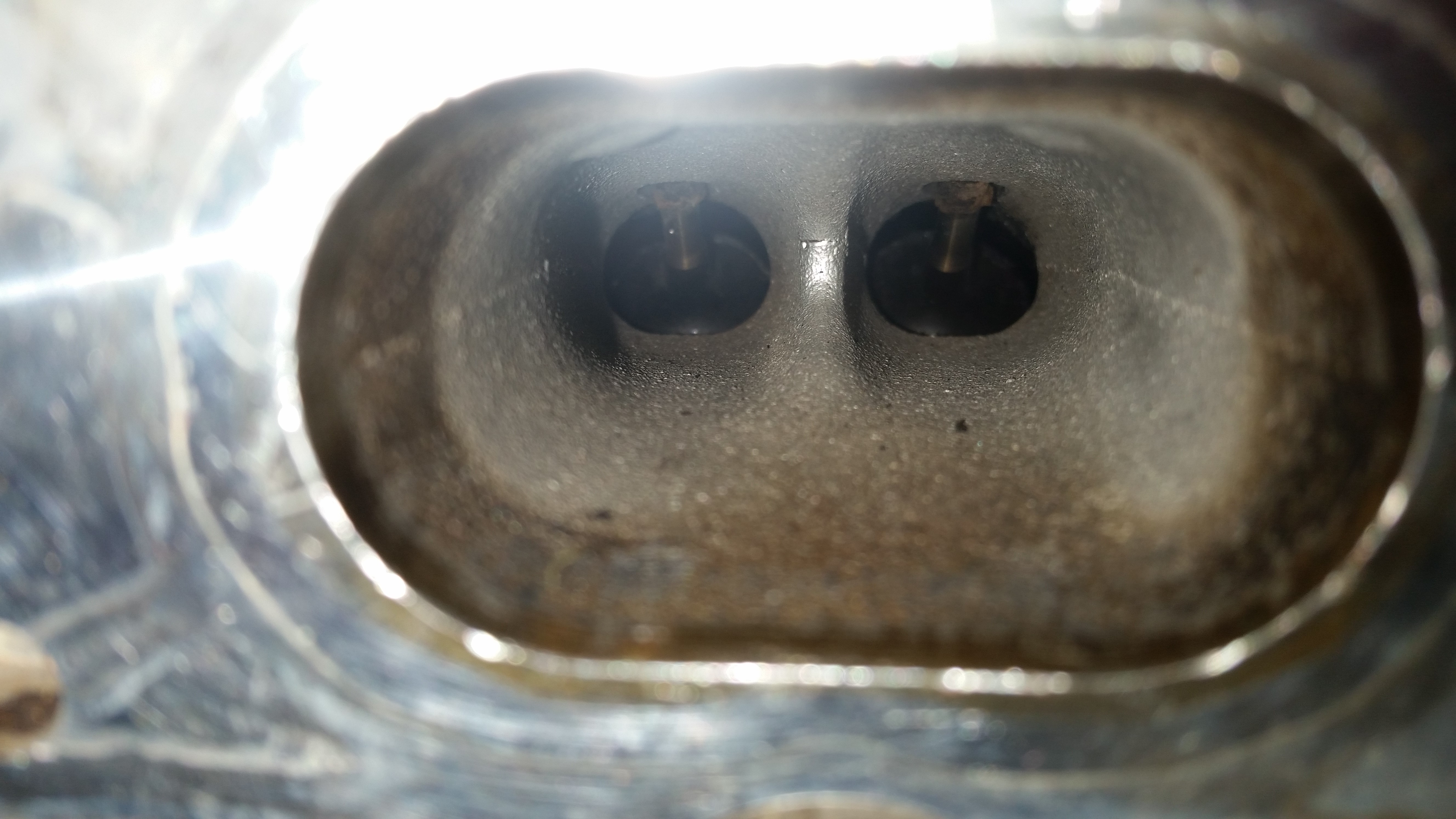

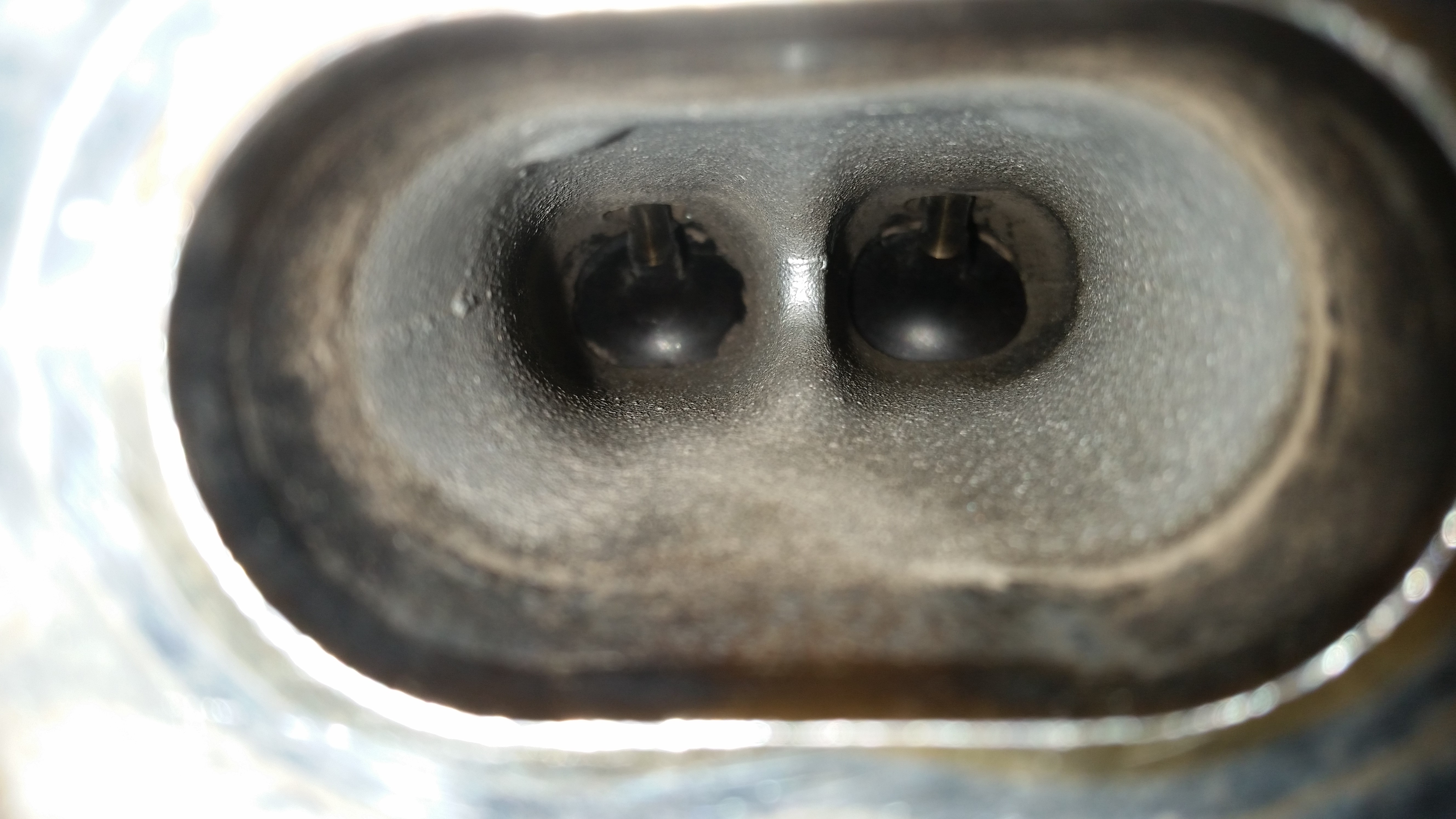

I must admit I took the day off work when I made the appointment with LTMotorWorks so I was locked into going to my appointment yesterday. I'm glad to report that my experience with LTMotorWorks was a very positive one! They started at exactly 9:30 am and were finished by 2:00 pm, they told me it was the toughest intake valve cleaning they had ever done, I was witness to that! Once they walnut blasted the top layer of dark black carbon deposits off, what they found underneath was extremely hard lighter color carbon deposits.
They took a moment to show me, then I went back into the waiting room. The walnut blasting wasn't doing anything to this lighter harder layer of carbon deposits, this only confirms the one picture of cylinder #4 (the least amount of carbon on the valves) in the last picture in my very first post where you see the light gray marks on top of the black carbon. This is where the Mini dealer stopped cleaning my intake valves because the harder layer was no match for walnut blasting, the fact that it was still there yesterday proofs beyond a reasonable doubt that the Mini dealer got lazy! This is why the mechanic claimed he forgot to take after pictures!
Even when LTMotorWorks used special picks and solvents it was still very difficult to remove and time consuming. Those light gray marks that ECS Tuning Guy menctioned in post #9 was the walnut media striking the hardened carbon leaving those light gray marks or scrapes on the valves. It may not look like much carbon on those valves in cylinder #4, but I beg to differ because I saw the cleaning process several times before it was finely finished. The valves seemed to get smaller and smaller as more carbon was removed, it looked less and less like a domed bell shape on top of the valves!
These pictures were taken about an hour before LTMotorWorks was completely finish cleaning my valves, I didn't want to keep interrupting the cleaning process because I had to leave for work by 2:30-3:00 pm because I knew I'd be in traffic for at least 3 hours! They were using sharp, long, curved dental like tools to remove the harder carbon nearest to the sealing area of the valves where the walnut shells can't get in, I've have seen other pistures of this Here, see the light tan build-up around the back of the valves sealing areas in the link titled "After Blasting"? I did however get to see with my own eyes the completed job, I thought about taking more pictures then but not losing my job is more important.
So how does the car run for you in comparison to when Mini did the "blasting"?

A big difference between the Mini dealers job and LTMotorWorks job, it feels much more responsive in Non-Sport Mode! The Non-Sport Mode feels very responsive to the lightest amount of pedal input where before you had to really floor it to get any kind of response, that's what most member's complain about for which they have the right to do so.
That flat spot in Non-Sport Mode everyone talks about is gone especially when your sitting at a red light and you get a green light, there's no hesitation or stumble like I clearly had before which is why I started using Sport Mode. It accelerates with ease and moves up the RPM range easily and quickly (Non-sport Mode).
On another note: is my idle supposed to be around 680-700 RPM? I thought they were supposed to be closer to 800 RPM at idle, Dash Command, Torque Pro and my in car RPM gauge shows 700 RPM's. It shows 800 RPM's at idle with the AC on. The ECU was reset and the Throttle Body Actuator was reprogrammed by LTMotorWorks because they had to clean the intake manifold and move the throttle body actuator, it idled at 700 RPM's long before I brought it into LTMotorWorks.
