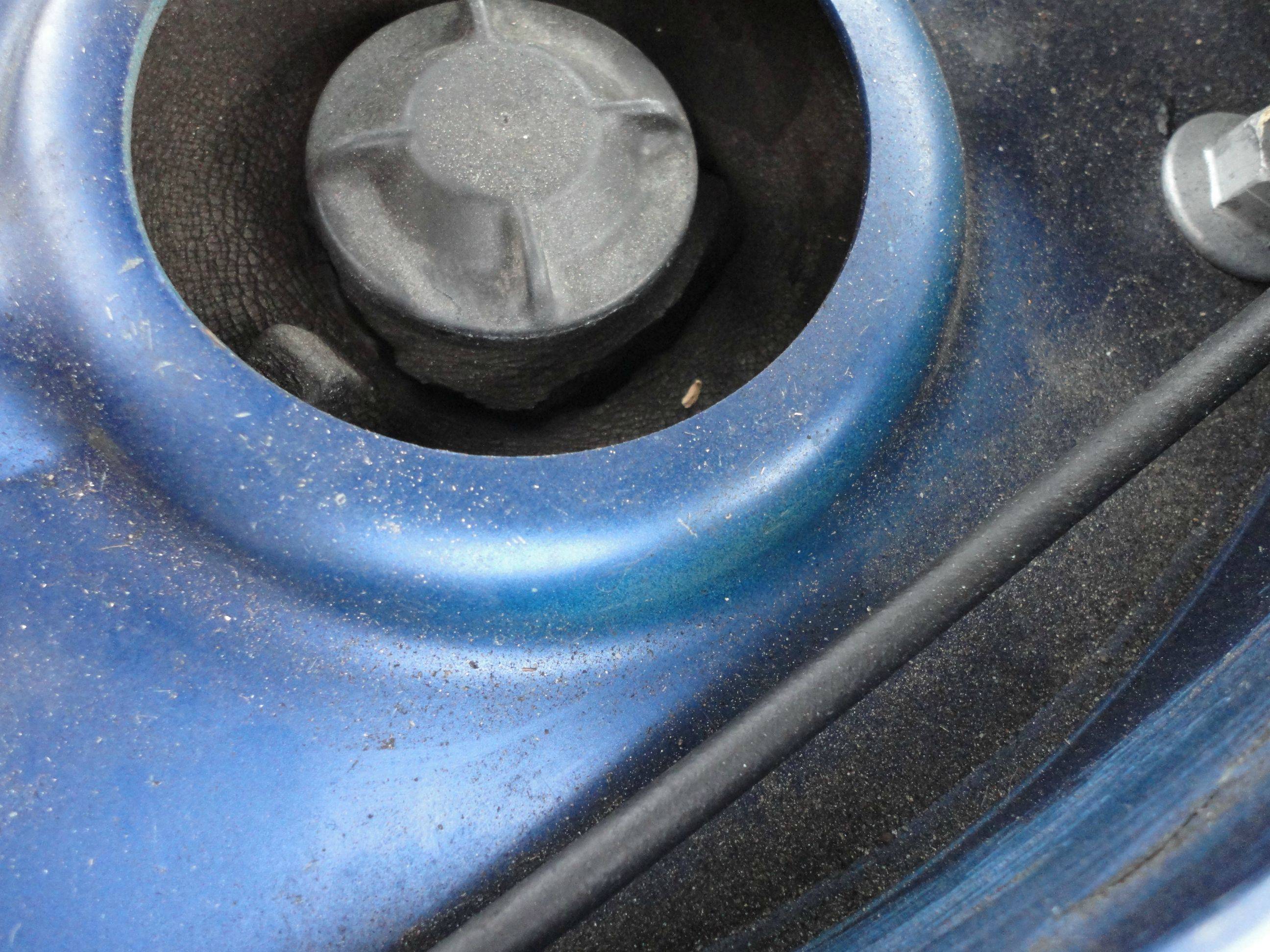

Old Jun 1, 2015 | 01:55 PM
Posts: 36,766
Likes: 2,552
Check the strut mount , then if its no the strut mount and/ if they were replaced check the steering rack lower U joint and pivot bushing they can creak.
Strut mounts:
The 3/2002+ gen 1 Mounts looks like that new. Old ones will also show cracking and splitting of the rubber on there way out.
31306778833
http://www.ecstuning.com/Search/SiteSearch/31306778833/
And More info here:
https://www.northamericanmotoring.co...3-r53-jcw.html
OR
https://www.northamericanmotoring.co...mp-help-2.html
