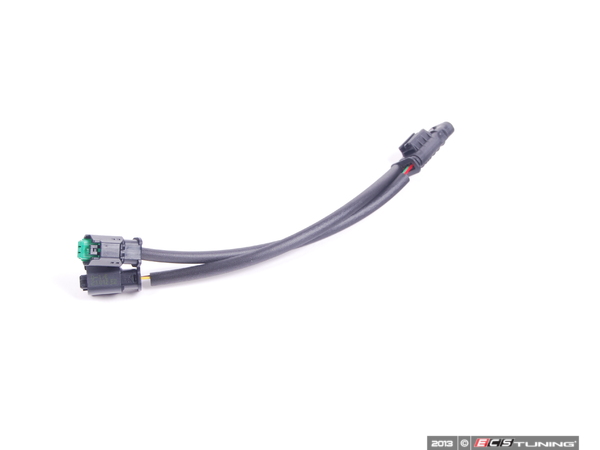

6/2010-3/2012 for JCW models need the pigtail wire. 12517646145

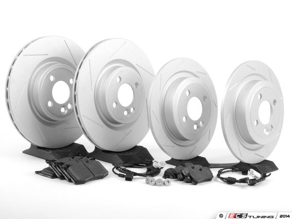

3. Brakes : Measure the thickness and the min thickness is maked on the side of the rotor on the stock rotors. If below replace:
http://www.ecstuning.com/Mini-2010-Cooper-R56-John_Cooper_Works-Coupe-L4_1.6L_N14B16C/Braking/Service_Kits/
