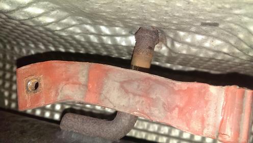

Pretty sure I found the rattles.
Are the hangers supposed to be this long?
is it safe to run without # 8 in the diagram?-forumrunner_20141223_155315.jpg
is it safe to run without # 8 in the diagram?-forumrunner_20141223_155236.jpg
is it safe to run without # 8 in the diagram?-forumrunner_20141223_155227.jpg

Originally Posted by v10climber
I could never really figure out the real purpose of that plate. I think it's just a stiffener for the body since it's pretty rigid/heavy but it's also held on with little 10mm bolts. You can't just space it down a few mm with washers to clear the new exhaust?
Well, the washers worked! I also shortened the hangers because they were banging into the side of the exhaust recess.
Rattle gone, but, I'd sure like to put one of those shiny ECSTUNING JCW systems on it...........
