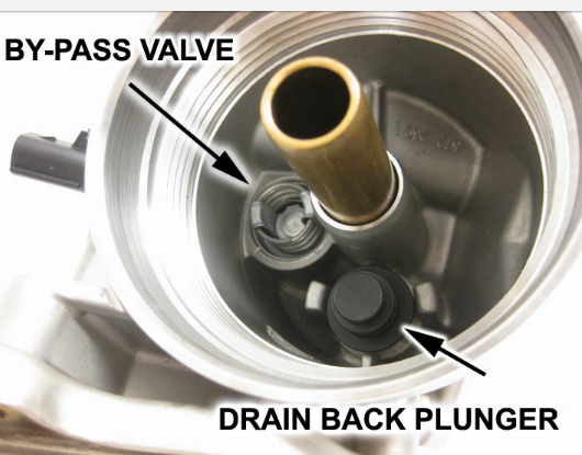

guys... do you have pix of what this spring looks like?

Name:  Screenshot_2014-12-09-00-34-21_zpsxbwdiog_edit_1418056553940.png_zpske4gmsgx.jpeg
Old Dec 8, 2014 | 08:50 AM
minsanity's Avatar
minsanity
Joined: Aug 2009
Posts: 1,505
Likes: 25

Thanks for the pix, Minsanity. Now I know what to look for if those parts break.
