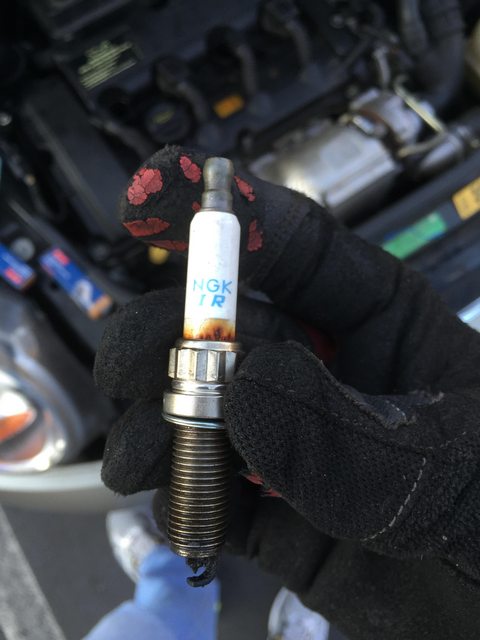

So start with pulling those plugs. Plug 1 seems ok. However plug 3 is covered in a hard oily substance and no way it was firing.
Shine a light into the plug hole and the top of the piston appears to have sludge on it as well. At first glance #1 piston seemed to be clean but it also has slight sludge on the top of the piston. Pulled 2 and 4 and they looked ok.

1.) Could it be possible that they got so bad it was allowing all the buildup into the combustion chamber and snuffing combustion?
2.) Is it possible a cracked piston could lead to this oily spark plug? I've been adding more oil fairly regularly which I think is attributed to the valve cover needing to be replaced.

I hook up to BavarianTech and it tells me Cyl 1 and 3 have a misfire.

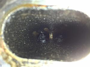

I also pulled the intake manifold as well. This was number 3. The worst one.
It'd be nice if it was just so gunked up it was getting closed. But that might just be wishful thinking. I do have another vehicle and plenty of tools. Been working on an E30 to replace the Mini with but it still isn't finished yet.

Your valves look like the worst case scenario I have ever seen!
Can't wait to see inside cylinder #3, it's not everyday you get to see what could happened to any of us. I wonder if the timing chain jumped a few teeth and cause a valve to collide with the piston.

99% sure the exhaust valve broke due to excess carbon buildup.

So, if we've got burnt exhaust valves, does one replace all of them, in case they too are compromised or just the ones that are obviously damaged? At $46 each, that works out to be a fairly expensive proposition, but still less than if another fails. Are they failing because they don't close all the way or are they just not very robust, so another is probably not far from going? Does anyone know a decent place to get a different brand of valve, that is hopefully stronger and/or cheaper? Anyone ordered custom ones? How much, if so?
If the other valves have carbon deposits around the edge then that would explain a burnt valve, this carbon on the outer edge is what heats up the valve and sooner or later it will weaken the valve. Another note is our Mini's run on the lean side so this is also cause for concern, to lean and your rings break. Add to that our operating temperature of 226F!

IMO the problem lies in the lousy design of PCV system. The design causes excessive oil vapors to reenter the intake which decreases octane, cakes up the intake valves and increases in-cylinder temperatures resulting in super hot exhaust valves.
If you are there replacing one, I would go ahead and do the others. Also, inspect the other components like seals, etc.
