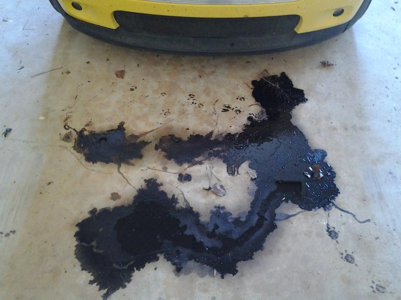

I stopped driving the MINI a few months ago. <br />
Here is a picture of the oil puddle that was formed. <br />
The reason it is two areas is because I rolled it back a month or so ago to hopefully keep the tires from having flat spots.<br />
Any idea what would be leaking from the picture?

Much easier to diagnose and oil leak from the stains/tracks on the car.

The VOLUME of fluid is what gets me (when it was stored!), was the engine cycled at any point (putting pressure back onto the leaks)?
If I'm reading correctly, it sounds like there are two separate spills involved in that image (and that the car was rolled back towards the top of the image). Without knowing the location of the car relative to the spills and angle of the floor, it's hard to say if it's from the front, back or everywhere on the engine - you'll have to get underneath.
With that much leaking, you'll have to clean the engine and then keep an eye out for where it comes from.
Lots of possibilities:
  • Valve Cover (unlikely it with that much volume when stored)
  • Oil Pan gasket (possible with that distribution)
  • Rear Main Seal (probable but with that volume - be careful of destroying your clutch)
  • Crank Position Sensor (likely, but not to that extent)
  • Bedplate seal (really doubt that it's this one, but I've seen & documented it)

The oil was very thick and kind of gummy on the floor.

It is the CHF11S power steering fluid. The resovoir is empty. I believe there is a recall on this isn't there?
