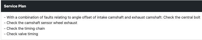

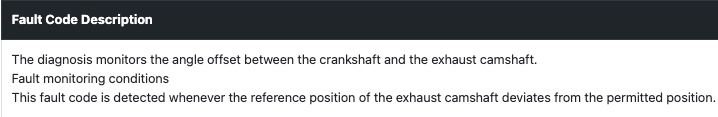

Your right its 2DA2 I checked everything Related to exhaust cam vanos solenoid camshaft sensors timing,,,,
The p1339 says it is crank shaft sensor cross wired...
Also the code only comes up while the car is driving if i clear codes and sit idle and even rev the engine the code doesn't come up...

Did you check the mechanical timing by installing the cam tool?

Was the same code present before replacing the timing chain?
Low engine oil level?
Did you reset DME VANOS adaptations after replacing the timing chain?
If you swap the two VANOS solenoids, does the fault code change to the intake camshaft?
If those are fine, you may want to consider a faulty exhaust VANOS unit.
