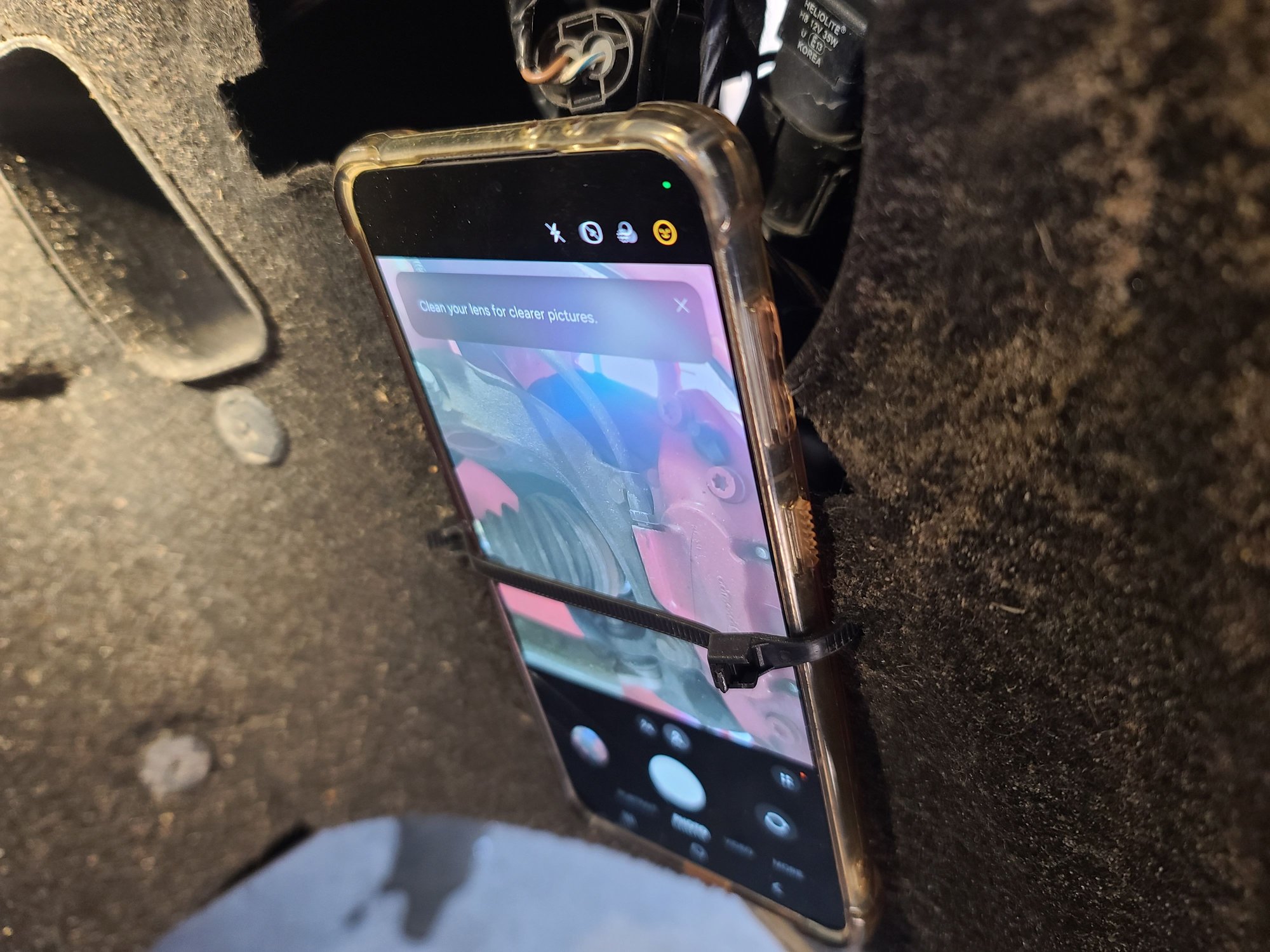

I'm gonna attach one of my old phones underneath and see if that's point it out better..

unfortunately the clunk was there when i 1st got the car. Wasnt nearly as bad but your right , installing the coilovers amplified the noise . I took a recording of the axle while driving but i accidentally recorded the outer part not the inner joint which I think is the failure point..
aaaaand you couldn't really hear any clunking from under there , somehow the road noise and wind was enough to drown it out. So the noise is DEFINITELY louder in the cabin than it is outside the car..
I will try the pipe trick today and see if I can try and pinpoint the noise but like you said ,since the boot is torn it needs replacing anyway now. I will just put on an entire new axle because it will eliminate it from the equation. Ille probably replace BOTH axles just because...

Well. It WAS a bad axle.
I installed a new axle and clunking is gone.. but lol now i gotta get rid if these dang interior rattles.
