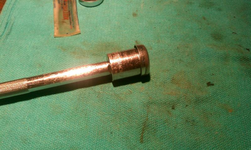

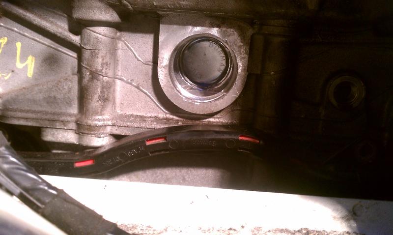

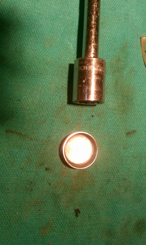

The inner plug is a 36mm stock. I put in a 36.5 mm steel one. Pressure tested the cooling system and no leaks. It's in there tight.
Outer plug is a 40 mm brass. I used Black RTV on it since I buggered up the hole a bit getting the old one out.
Now I'm waiting for parts to put it back together.
