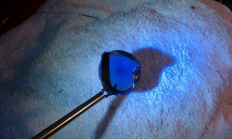

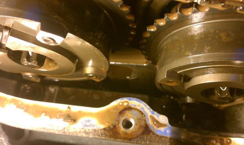

Here's a few pics of the hole and plug.
Attached Thumbnails Head Gasket or Cracked Block-imag0020.jpg   Head Gasket or Cracked Block-imag0021.jpg   Head Gasket or Cracked Block-imag0024.jpg

Dang, not an easy place to reach. I remember many years ago I had an old Dodge pickup truck that popped a freeze plug. Fortunately, it was on the outside of the block. I put one of those adjustable rubber/metal plugs in it's place. Lasted the life of the truck. Am not sure that would work on an internal freeze plug. Thanks for posting the pics, first for me on a mini..

Wow I'm speechless, never would have thought it was a freeze plug! Looks like that freeze plug ended up hitting something inside your crankcase!

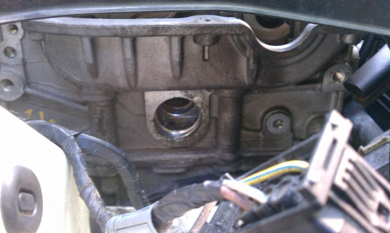

Removed the outer plug.
Attached Thumbnails Head Gasket or Cracked Block-imag0037.jpg   Head Gasket or Cracked Block-imag0039.jpg

Now that's interesting, I was wondering how you were going to reach the original plug. Thx for the update..
