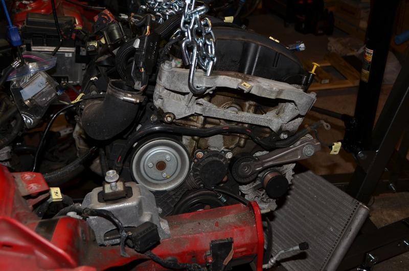

When I took my engine out the other week (long story, pic below), what looked like a minor valve cover seepage had produced solid coating of oil on the entire pulley- and back sides of the engine.
If it's not the valve cover and not the chain tensioner (re-torque it!!), then we are down to the crankshaft seal. I haven't heard of it failing often, but the good news is that it's inexpensive and I believe you can get to it by removing the passenger-side fender liner.
If the front of the engine is oily as well, suspect the oil turbo cooling line leak. They all go around 50-60K miles.
I would plan on replacing the accessory/serpentine belt as well, as all that oil has shortened its lifespan.

Sorry it took me a while to get to it, but below are the out of the car pics of the pulley-side of a used N14 engine.
As you can see, there are no external oil pump covers.
The only obvious places for the oil to seep out, top-to-bottom, would be:
- valve cover gasket (they all do it to some extend!)
- cylinder head gasket
- draft shaft seal
- chain tensioner (many do it if the tensioner was under-torqued)
- cylinder bottom gasket
- oil pan gasket
However, oil leaks are rarely obvious. It may leak in one place, then gravity and air-flow travel around multiple parts of the engine to drip elsewhere.
The only way to tell for sure it to clean the visible paths of the oil leak, watch them re-emerge, then trace to the source.
Hope this helps,
a
