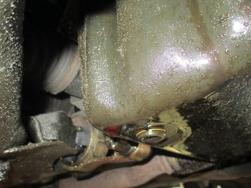

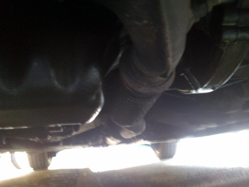

pic
here are some pics
also I have noticed that coolant has gone down a bit too

Take it to the dealer for diagnose. My 2010 non-s clubman had the same leaking area. After diagnosis, it was the timing chain tensioner was backing out causing the leak. Dealer then replaced the timing chain tensioner with an improved version. It has been fine since then. Though I just sold the clubman 2 days ago.

Based on the info provided, my guess would be a leaking turbo oil feed line and/or return line or the gasket for the oil filter housing.

I don't think this is a turbo oil leak, as the OP has a Non-s cooper.

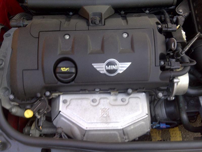

Old Jul 16, 2013 | 12:55 AM
Monopoli's Avatar
Monopoli
Posts: 17
