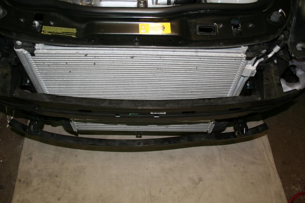

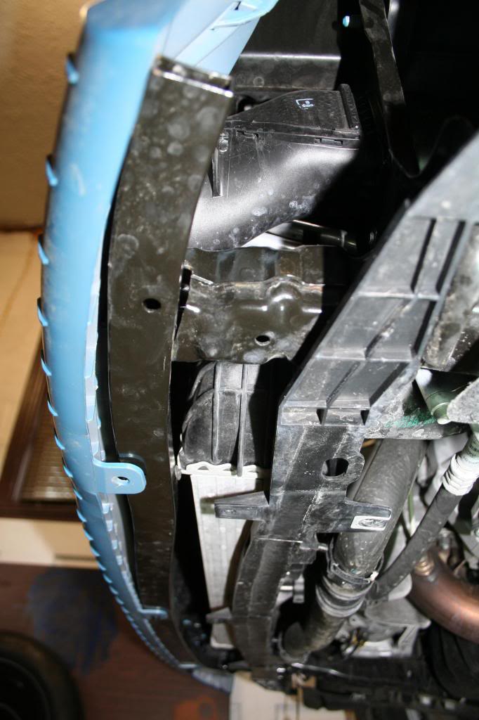

Long story short my wife drove over a curb and what now looks like she was stopped by a pole. (more info here: https://www.northamericanmotoring.co...425-post1.html)
I'm pretty bummed. After removing the front spoiler I uncovered something I wasn't quite ready for. The crash prevention bumper frame got bent (see below). Now I know she hit the pole and that's what stopped her...
Now I really could use some support to help me decide what to do
Nothing else seemed damaged. The IC got close though but it's not touching. All the painted body parts are okay which is amazing considering the bend.
1: It looks like I could put everything back together and pretend it never happened. Visually nothing would really be noticeable. The main upper bumper metal frame has not been affected as far as I can tell.
I just put everything back together and you wouldn't know something behind is bent.
2: That all said I am a little concerned the frame has being hit enough that in case of an accident it could possibly reduce protection so I may have to change it, I'm not sure...
2a: The car is new from this last August and that's a real bummer. I could just take it to the dealer. Have them quote me the repairs and have our insurance take care of it. Ofcourse the car would take a real hit on its value and I would still have to pay for deductible.
2b: It looks like I could also entertain doing the work myself. It does't look too bad to do myself (I very manual) but I'm not familiar with removing the MINI entire front bumper and I'm not quite sure what I'd be getting into yet. Further more I'm having a hard time identifying the metal bumper part frame and I'd need to find information on bolt torque numbers as well...
Anyway, can anyone chirp in and help me out decide what to do...
What do you think I should do?

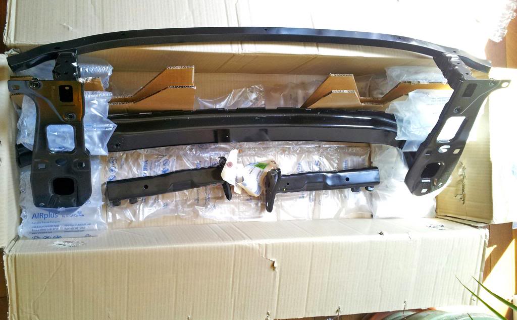

Just got the parts today.
It sounds like I have my Saturday or Friday night cut out for me...
The parts are surprisingly light!

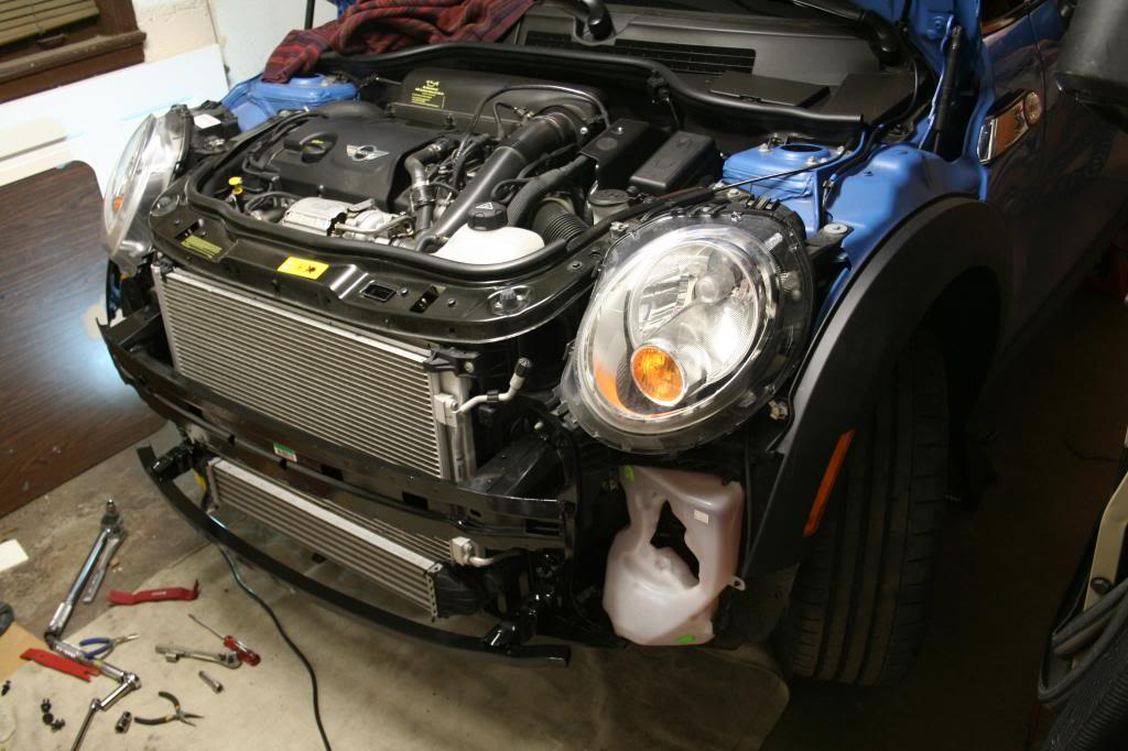

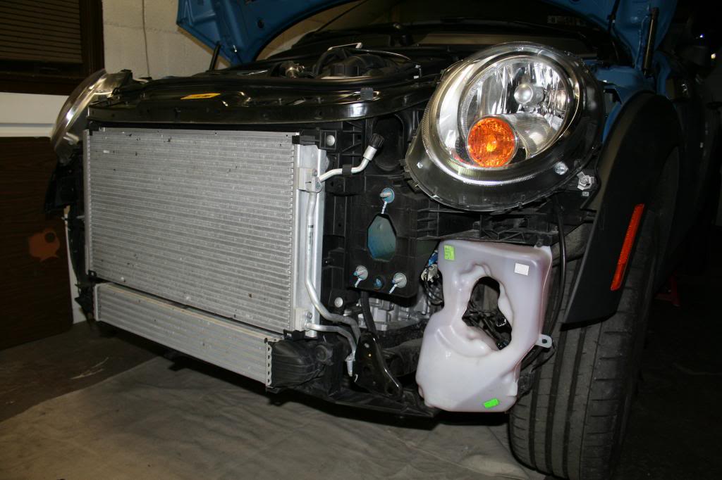

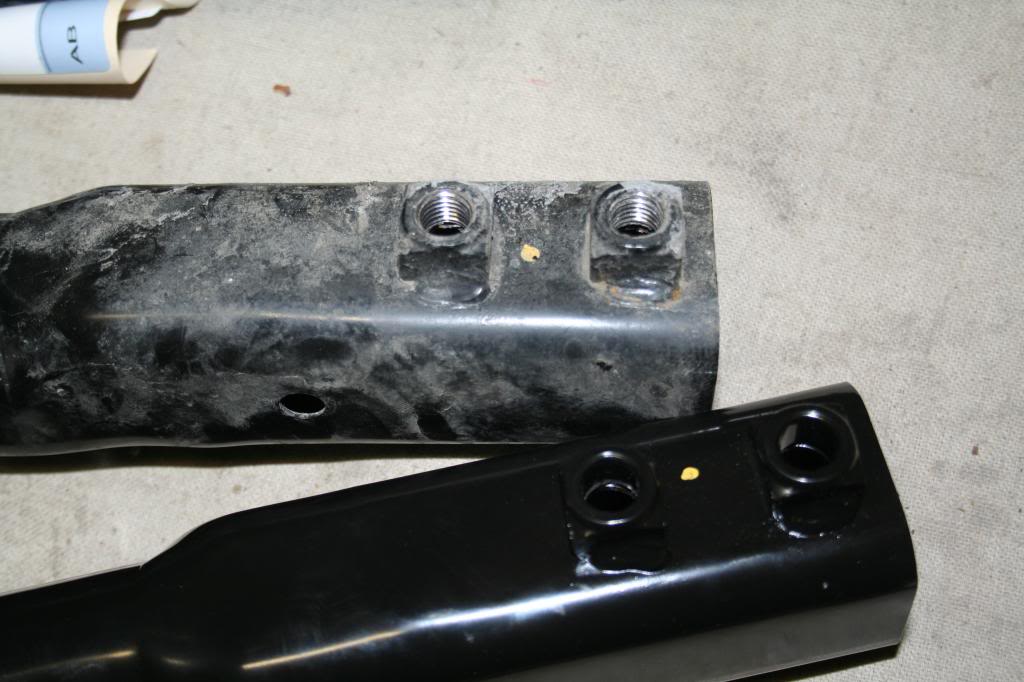

Okay, mission accomplished! I spent the entire evening replacing the bumper inner frame...
Replacing the frame itself was pretty easy.
Removing and remounting the bumper wasn't so much fun.
But everything considered it wasn't too bad since I was able to do it in one evening. I was prepared to finish in the morning but that did not happened so over all that was definitely worth doing myself...
Oh, and I could not use the lower crushed tube since for some strange reason the bolts were not threaded :confused5: . . . maybe they are self threading but since I wasn't sure I decided not to take the chance to damage the bolt.
Of course I checked very well the current one and it seemed perfectly fine with no deformation so I feel fine about not having been able to replace it.
