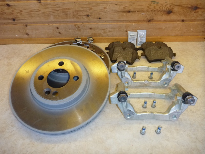

If you look at the (new) caliper bolts in this photo, you'll see the band of threadlock that comes on them. BMW include replacement bolts with their brake discs so that mechanics don't need to use (liquid) threadlock. It's the threadlock band that is single-use, not the bolt itself, as far as I am concerned.

Makes sense, thanks for that.
