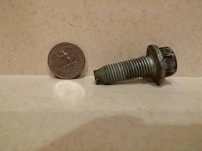

This is going to sound pretty vague, but I'm wondering if anyone can recognize where this bolt may have fallen off of.
My son and daughter, drove slowly over a speed bump. The roof was down so they were able to hear a metallic noise hit the pavement. They stopped, and found this bolt on the road just behind them. It was still warm.

Don't rule out that the bolt may not be from your MINI.
A very similar thing happened to me once - drove over a bump I shouldn't have and got out afterwards and noticed a broken plastic part that I was sure came from my MINI. Took the plastic piece to the dealer, searched all the parts diagrams, and we all concluded it was from a different car.
That bolt does look like a subframe or similar bolt (can't say for sure which one, been a while since I lowered the subframe!), but at the same time, I would think it would be more likely to just shear off than come out in tact like that based on your rendition of the story. It looks like someone just unscrewed it. My theory, if it is from your car, is that maybe it was loose or even has been out the entire time since those repairs, and the speed bump just jostled it to the ground.
Make your own call as to safety, but I would say if you don't notice any vibrations that weren't there before, you should be fine for that grocery run.
From the size of the thing, I at least, would thing it was holding something important. I would suggest getting it on a lift, or at the least, jack stands and having a look underneath. Don't go rooting around under the car with it just on a jack though.
Then again, like the above post says, maybe they dropped a bolt during maintenance and couldn't find it to get to it and just replaced it. It could have shaken loose while driving. Considering the time of year and the recent weather it would have to have fallen from somewhere on the car that is generating heat since it was warm when they picked it up.
That bolt is used on a few things in your MINI.. Check your brake calipers..also the same bolt is used in the cv joint closest to the hub.. It bolts the hub to your car..very likely they removed it if you recently had a cv joint replaced.. Its very likely to have come off the front of your car near your brake caliper..If it was warm that's where I would start to look.. Once you start looking under your car you will see how many places that type of bolt is used.. good luck!

Wow! Thanks for all the great responses.
I like the thought that it's not my bolt.
* A 17mm socket would turn it, but it's a loose fit, and a 16mm is too small. A 5/8 fits it perfectly. Does MINI use 5/8 bolts?

If it is not 16 mm or 17mm, and 5/8 is perfect, I would say it is not mini. Mini will be all metric. That would make it likely to be something picked up as highway debris that fell back out. Checking on a lift is a good idea to be safe.

I would not be comfortable making assumptions about SAE vs. Metric based on head size alone. Go to a Home Depot hardware section and you will find boards with various 'test' nuts and bolts. Base your conclusion on thread configuration, not head size.

Checked on a couple common bolts, did not see anything close to that design, but would get the thread size measured and the head to be sure its metric. Also getting the MINI up on a lift and going through all the areas that were serviced last as a double check. Also check if there is any aftermarket ( non factory) items on you MINI, some use standard size hardware that does not directly bolt to the body. Good luck and have a great new year.
Rear Bolt for the carrier. #3 looks like this.
http://www.ecstuning.com/Search/SiteSearch/07119904141/ES14500/
And used on the front carrier to bolt in the wheel bearing.

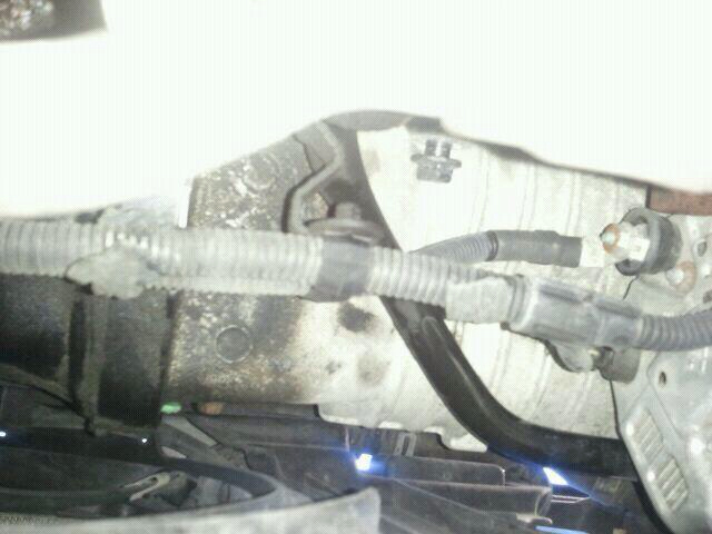

Mystery Solved
Uhhhh...... so, don't be too mad at me...
First:
The bolt is from my MINI. It was from the engine mount that had been replaced about a month ago (see attached). The mechanic was unsure of why it would have loosened, but I am to keep an eye on it and see if it begins to loosen, again. In my inexperience, I could have scanned the engine, and would not have seen where it had come from.

I am very embarrassed that I gave some false information. As many of you have already deduced, that bolt was, in fact, a 16 mm. I could not believe this when the mechanic told me that. Upon closer review of my sockets, it turns out that I do not even own a 16 mm socket. My set goes from 17 mm to 15 mm. I grabbed the next socket in line, and in the poor lighting and my quick look, I saw the '5' as a '6' and just made the assumption that it was a 16 mm socket. I apologize for that.

First:

Good thing you have it double checked. Part number for that bolt is 07119906199 . That could have been a older design bolt. The newest design does not have that extended pieces before the threads start at the bottom.
#4 in the picture on the newer design engine mount.
