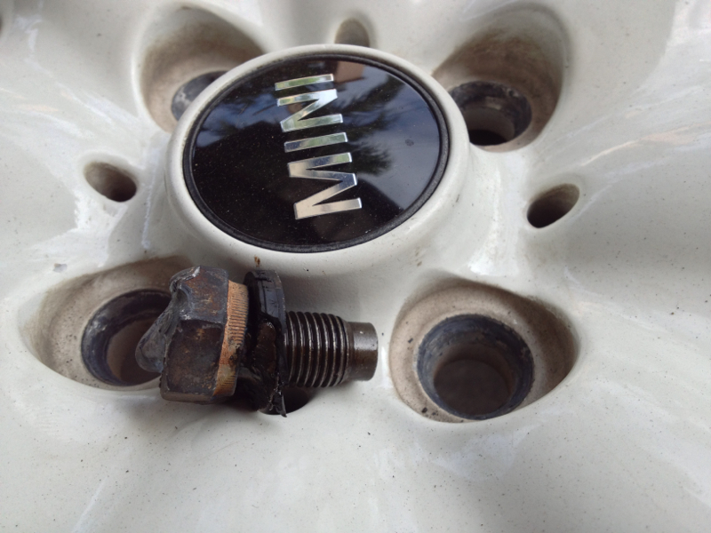

Happened to me as well. The plastic cements the bolt into the oil pan. The pipe wrench did not help too. Maybe it was too late when we decided to rip out the pipe wrench.
We had to weld on a new head to get it off!
Luckily, I had bought a magnetic oil drain plug before hand. Yikes.
Sorry, The iOS App is acting crazy with the pictures. :(
Attached Thumbnails Rounded oil drain plug-image-1596245025.jpg   Rounded oil drain plug-image-313768463.jpg   Rounded oil drain plug-image-1354182977.jpg

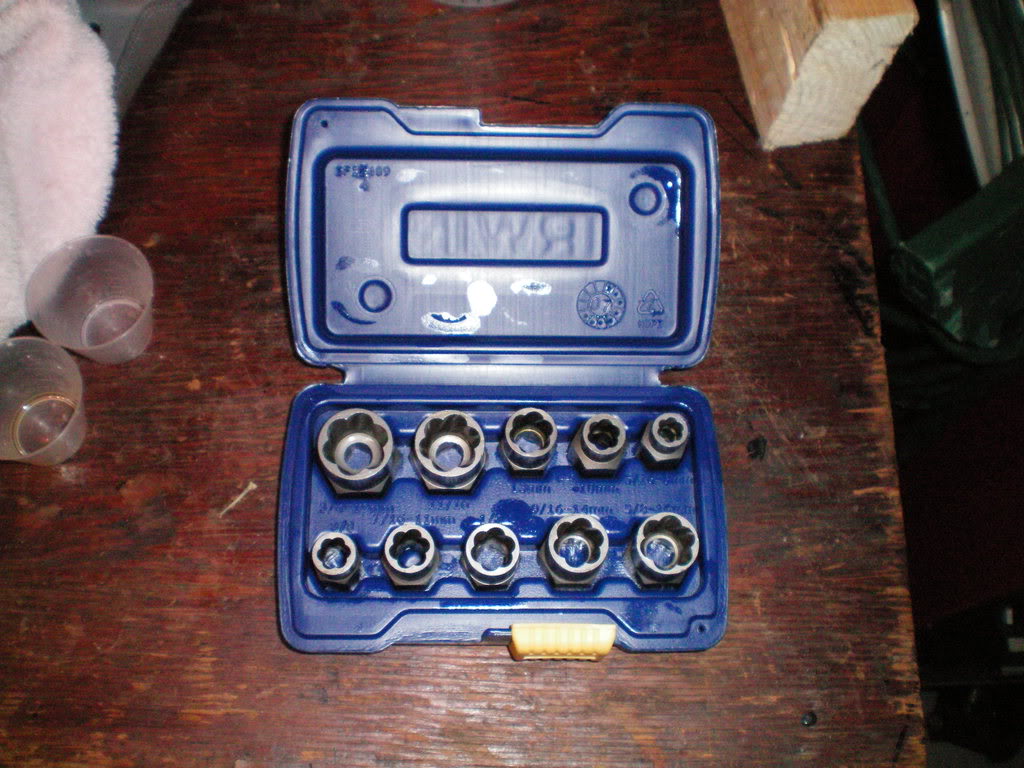

So I grabbed the Irwin bolt extractor the Captain mentioned, from AutoZone, and hammered it onto the rounded over drain plug. Rather than use the 3/8" breaker bar, I used a 19mm box wrench on the bolt extractor for the additional leverage it provided, but could not get the drain plug loose with my arms nor with restrained tapping with a hammer. Finally I positioned my body toward the driver side wheel well and pushed on the wrench with my foot, putting my leg strength to work. The drain plug came free from the oil pan, and I commenced with the rest of the oil change procedure.
I found with my old VW that shops over torqued the drain plug such that eventually one of them told me they could not work on it unless I replaced the pan (though they had been the last to work on it...) and eventually I had to have a shop replace the drain plug with an oversized plug. I don't think over-torquing of the drain plugs by shop personnel is limited to just MINIs. Quality mechanics are hard to find and when you find one, hold onto them.
