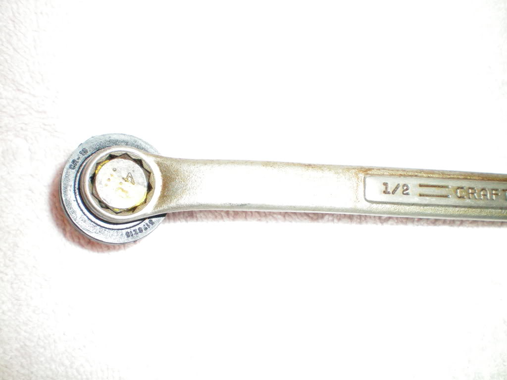

on the GEN1 MINI I agree the problem is partially that integrated seal - the plug becomes glued down as well as just tight. AND fit of the tool is critical, especially since the recommend size is actually wrong . . . it will work but it is not the best fit.
This is a picture of a GEN1 MINI oil drain plug . . .
that's a 1/2 inch wrench which is a tad smaller than the recommended metric. Note that the wrench fits with NO slop. A 6 point is better - this wrench is just a good open box used here for the size reference.
I recently had a similar issue trying to DIY an oil change on a Kia Soul .. no socket seemed to fit right. Everything that fit on, was sloppy and I did not want to screw up the bung. Finally I got the size wrench that seemed the right metric in a 6 point box, placed it over the nut and tapped it down with a hammer ... just hard enuf to get it down and tight. Seems the paint on the darn thing was enuf to mess up the fit. Bung came off once I was able to apply enuf force now that the wrench didn't slip and screw up the bung head.
