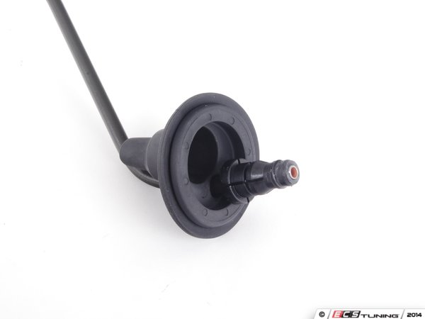

Well it has been awhile since I have posted or replied to this thread. However I did figure out what the draft under my dash was coming from. Near the steering column and clutch pedal you'll see a gasket that allows the fluid line to the master cylinder. If you see this gasket pulled back at all there is a real good chance that could be it especially if you've had any wires run from underneath your hood cause if would be a great place to run them. So check it out if your having issues.

It looks like this, the little gasket on the clutch line correct?
Part # 11 Clutch Line * gasket is not a separate part

Yea that looks like it is in the firewall you will know when you see cause the hose going through it goes directly to the clutch pedal you can see it really well if you remover the knee bolster under the steering wheel. I f you do that you will look directly at it. Mine wasn't even out that far kinda halfway out I never would have thought it would have been it at all.
