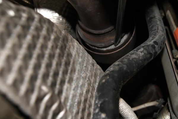

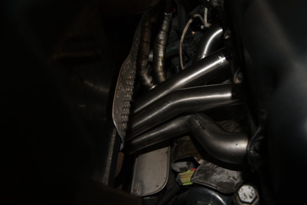

You are speaking my language! JUST had this happen to my '05 MCS at 89k miles.
My OEM header split into two recently. UPS should be dropping off my Milltek unit today as a matter of fact. Install will be tomorrow for me so I can get back on the road. Amazes me how MINI never built in a flex joint since they welded the CAT onto the manifold.
I will be taking photos and documenting the process if you are interested in following. I've received requests as well to video the sound after the install since people are interested in the Milltek header/exhaust combo.
$1,100 later... (wife not happy)

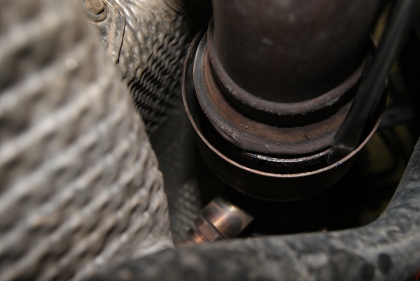

I complete the little write up here: THREAD LINK - POST #8
