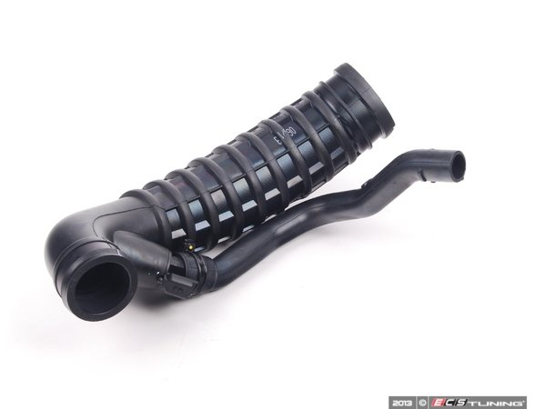

I would check two areas on the intake side if you are looking for an air leak.
#10 ( ribbered version ) maybe cracks near the turbo inlet and the small tube that branches off to the side.
Rubber Boot Part # 13717555784
http://www.ecstuning.com/Search/SiteSearch/13717555784/
Possibly maybe a connection on the back side near the sound generator ( if you have not deleted it ,# 8, #10 and #13 . 1/2 of #13 & #16 is just a sounds side.
Good luck.
