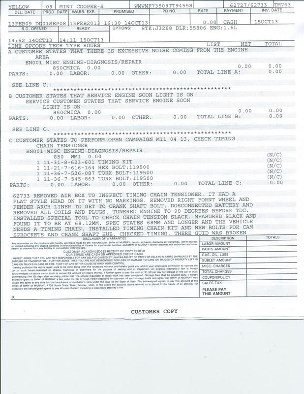

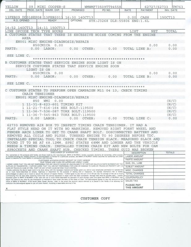

First time poster. I wanted to add my experience and a BIG THANK YOU!
I've had the rattle for months and thought it was my muffler or something not very serious. It actually gave my car a cool throaty sound. Well this past weekend my check engine light came on and the engine started knocking a bit. Took it to my local mechanic and the pulled a code for cam shaft timing and suspected my timing chain needed to be replaced. I freaked at the quoted price and started googling mini timing chain issues, which brought me here.
I called the local Mini dealer (MINI of Murray (Salt Lake City)) and the Service Manager was very vague and couldn't tell me anything without looking up the VIN. He then said there was an Open Campaign that did effect my car regarding the timing chain tensioner. They needed to take a look before they could determine the problem.
Bottom line, he said there was an Open Campaign, and my car was the first one that was affected at their dealership. I've included the invoice, interesting about the 2nd Open Campaign because nobody mentioned that.
Also, the dealership was awesome about getting my car back to me the next day. I've had my check engine light come on a couple of times a year and have always dreaded taking it to the dealer because of the crappy service I've received in the past, but they really came though this time.
Bottom line, I was about to shell out a couple thousand dollars before finding this post. Thanks again.
Attached Thumbnails MINI has issued campaign/recall to replace timing chains!-invoice-page-one.jpg   MINI has issued campaign/recall to replace timing chains!-invoice-page-two.jpg
