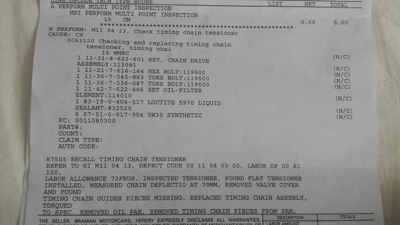

Just had my Clubman serviced at Braman BMW/Mini. Engine is noticeably smoother. They found pieces of the guide rail at the bottom of my oil pan so oil and filter were part of recall. They even supplied me with a loaner for the 4 days my Clubman was in the shop. I am attaching a copy of my receipt for each part number with their findings. Good luck
Attached Thumbnails MINI has issued campaign/recall to replace timing chains!-20131106_001403.jpg   MINI has issued campaign/recall to replace timing chains!-20131106_001426.jpg
People keep saying "Service Campaign" and your receipts state "Recall". I wonder why people don't believe you when you say you were told it was a recall?
