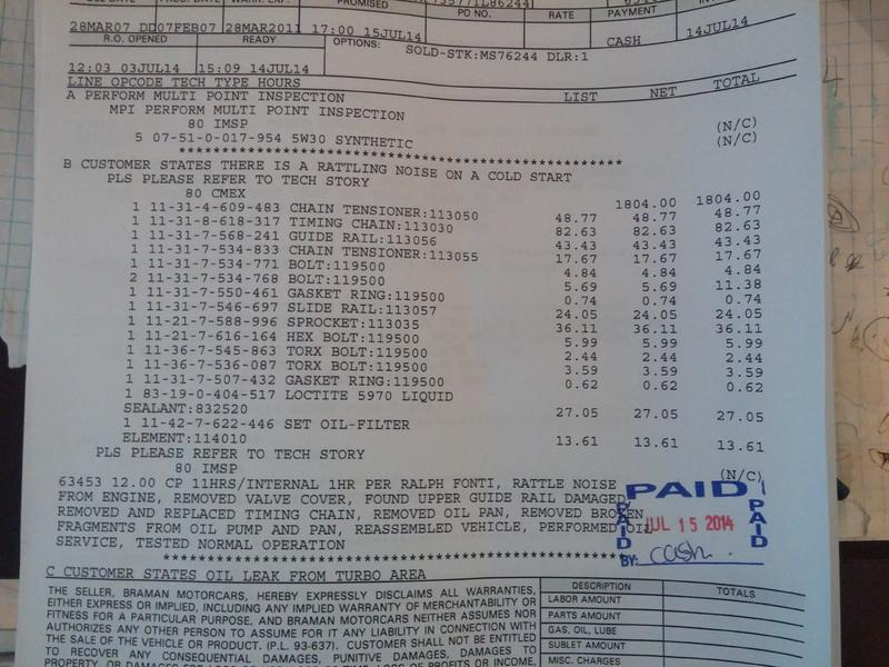

God I love timing belts! Soo much less maintenance compared to timing chains, you can change a timing belt without the need for going inside the engine to replace and there far more consistent. The new VW GTI's use timing belts now, VW made a smart move by going back to the timing belt. This also makes the engine much more quiet! No defective chains, broken guides and no tensioner failure. Imagine if MINI had gone with a timing belt for their R56 MCS, they wouldn't have such a bad reputation from blowing engines.
Just wanted to post an update for those videos I posted within the last few pages. I took the car to mini and they found the guide to be broken. so new tensioner, chain, guide. $2300, 3rd party warranty covered it.
it appears the sound in the videos I posted is the vacuum pump. since it made the same noise when I got the car back. I disconnected the pump and the sound was gone. I don't know if the mechanic just assumed it was the timing chain rattle sound or if they heard something besides the vacuum pump.

I wonder why you paid so much more than I did via extended warranty company, the total for my timing chain, tensioner and guides was $1600. I still have the invoice.
i attached my invoice. I think part of the 2300 is a $99 diagnostic fee for the turbo oil line that the warranty wouldn't cover.
Attached Thumbnails MINI has issued campaign/recall to replace timing chains!-2014-08-23-14.04.33.jpg   MINI has issued campaign/recall to replace timing chains!-2014-08-23-14.05.39.jpg
That's kind of nuts considering the oil line to the turbo had the recall for the heat shield to prevent it from going bad, and now that it has Mini doesn't want to pay for it even though it's clearly a defect.
yeah. its pretty lame. if you ask mini I think they will say the heat shield is to prevent oil coking and not mention the rubber o-ring. I replaced my feed and return lines with the detroit tuned one.
