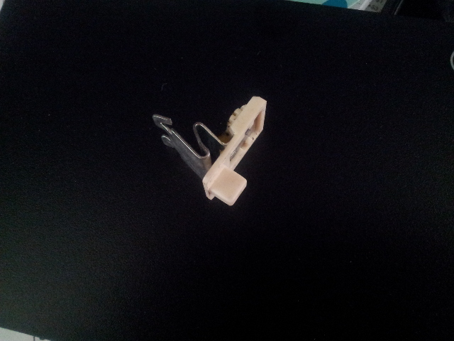

The passenger side door latch has been acting up. When you least need it, it refuses to open from either the inside or outside. I figured I would take the time today and dive in.
I can't seem to find any thing obviously wrong but don't want to put the interior door panel back on until I have fixed something to make the problem go away.
Any thoughts would be greatly appreciated. I have replaced the cable from the front door handle but that did not resolve the problem.
When I looked inside the door, there was a clip laying in the bottom. Any idea what it is an where it goes?

Looks like #7 from this page:
http://www.realoem.com/bmw/showparts...71&hg=51&fg=10

Wow. I would never have found that but that is what it looks like.
Any idea how I get that back in there?

Yes ,
That's the correct part. You can get them as a set also, used as a fix for the slight window rattle.
Part number #9 in diagram. Part 51337177925 the set fixes both slide rails.
http://www.ecstuning.com/Search/SiteSearch/51337177925/ES94364/
They mount to the each side of the sliding fixture that the glass mounts to. Look for the little rectangular clip that touches the black slide rails.
They are on the back side of the rail and face towards the outside door metal skin and might be a little tough to get to.
