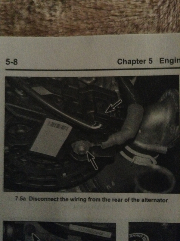

I'm thinking if it was "Bench Tested" that means it was removed from the car to be tested. Does your belt slip? I doubt that's it in your case, but is a possible cause.
How are the wires/pins in the clip that connects to back of alternator?
I assume car starts and accessories work (until your battery looses its charge) That would mean fusable-link/main fuse is not blown.
Not sure if your bench test tested voltage regulator or not -it's a part of alternator and cannot be replaced separately. To test, put a volt-meter on positive and negative battery terminals. Should be at least 12.6 volts. -Start engine, check battery voltage again, should be 13.5 to 15 volts.
I'm thinking the wiring mentioned (and in picture) is suspect. I don't think you have a failed power-steering that is causing your battery to not charge.

Thanks for your help guys. I've checked the ground wire on the passenger side engine mount and cleaned up the surfaces a dozen times now at least
Also checked the pins on the alternator plug as well as the wire.
The guys who bench tested it took the alternator completely apart as well and said everything was fine, but I will call tomorrow and ask if they checked the voltage regulator. Belt doesn't slip at all either. All accessories work fine
(besides power steering) until battery dies as well.
