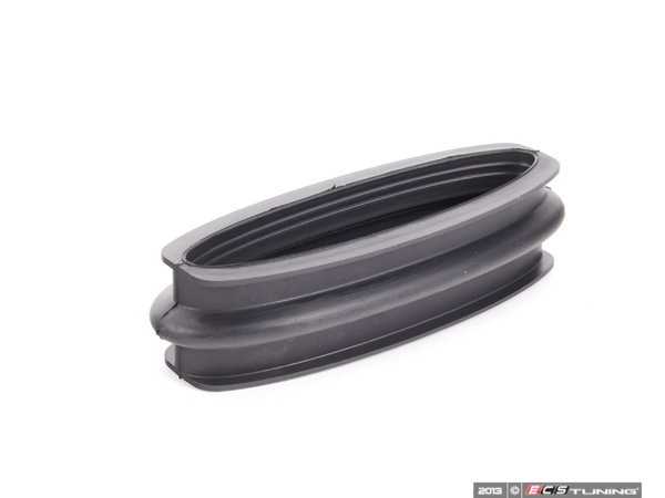

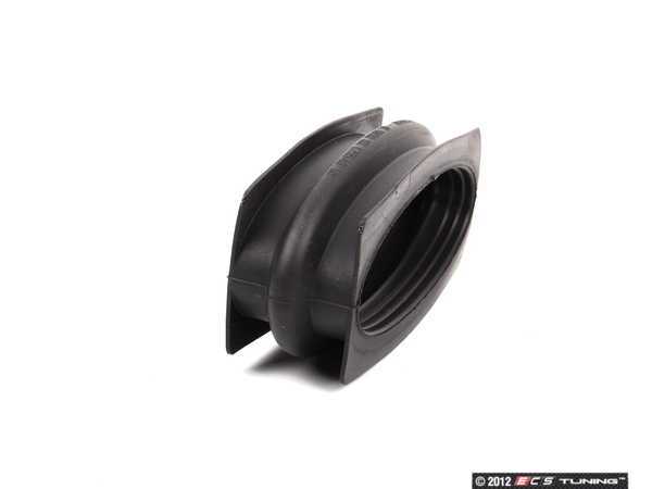

I would check the boot. Most likely when the re-installed the SC something was not sealed up.
http://www.ecstuning.com/Search/11610020836KT/ES2588236/
It will be the two black boots in the picture. Hopefully he replaced most of the gaskets on the install of the new SC ?
They look like this.
http://www.ecstuning.com/Search/17517639960/ES2543383/
http://www.ecstuning.com/Search/17517639959/ES2618867/
Hope that helps you out. Once you get the one fixed , then you can determine if the PS pump is at fault also.
