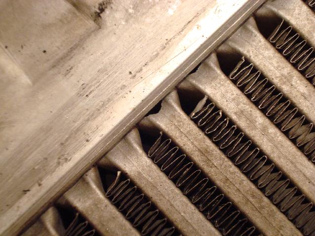

Thanks for the tip. I actually cleaned the IC 2 weeks ago. When I popped the bonnet today after work, I noticed an abnormal amount of carbon (or some sort of black crap) on the IC towards only one corner of it. I would normally ignore someting like this and just chalk it up to being dirty, however, being that I had just cleaned it; I took a closer look. As I looked closer, the IC sucked the cherry out of my cigarette. So, it looks as though there is a nice little break in the welding from one of the center veins where it connect to the side if the IC. So, on my way home, I picked up some J&B weld, a wire brush, and a couple bottles of brake cleaner. I'll be working on patching the IC up tomorrow and let you all know how it turns out. I guess at this point, if anyone has a nice new M7 or Alta IC, maybe you can part with your old OEM one.

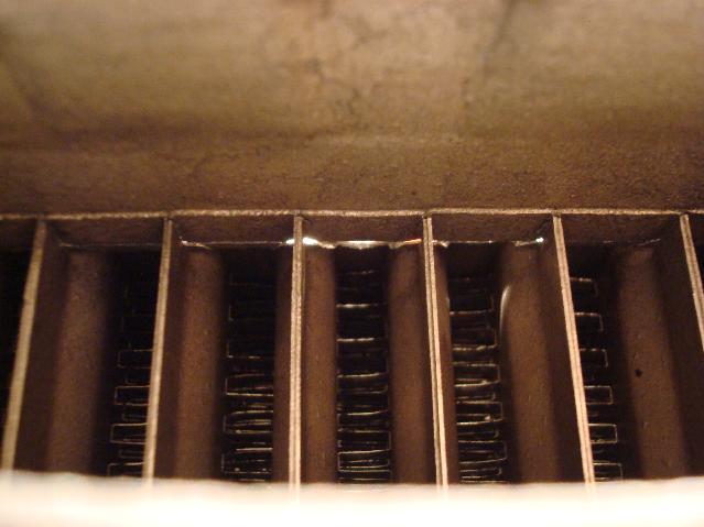

I yanked off my IC and cleaned it up. Heres what Im looking at. Aside from the two holes, it looks as though theres a break in the weld running a couple inches across. It looks like a manufacturing defect to me, but unfortunately, my warranty is up.

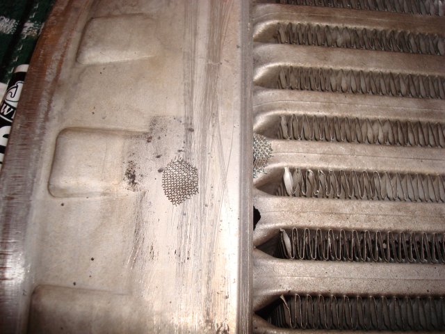

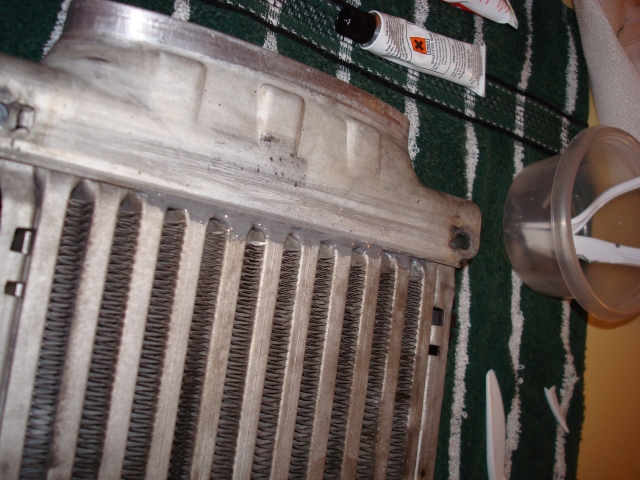

So here's the fix. I got a spare aerator (sink) screen and cut it to patch the two larger holes in the IC. Then I got some JB weld and filled the holes and crack on both the inside and outside of the IC. I let it sit for 24 hrs and popped it back on the car. Both fault codes cleared and all my idiot lights turned off after the ECU was able to make adjustments to the fuel/air ratio. My idling issue cleared and I suddenly had a lot more power that had long since disapeared. Life is good!
