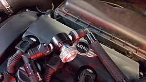

In Poland you can buy very high quality universal catch cans for really not big money, around 50 eur plus shipping around 15-20 http://properfekt.pl/akcesoria-samoc...atch-tank.html . In USA i buy UPR catch cans for good money that I use in Mustangs and last time I adopted one to my Mini, http://www.uprproducts.com/mustang-b...atch-cans.html Photo of one installed Mini attached. Keep in mind this should be installed on passenger side, here where I installed should be bigger with 3/4 inlet/outlet
Attached Thumbnails PCV Mystery solved!-20171223_152054.jpg   PCV Mystery solved!-20171223_151248.jpg

Hi Caniggia thank you for the pics.,,. so it should be installed on the back pcv hose ,, how come you installed it on the driver side pcv ?

I wanted to install 2, but had no time, this was easier but that was my bad as stated above.
