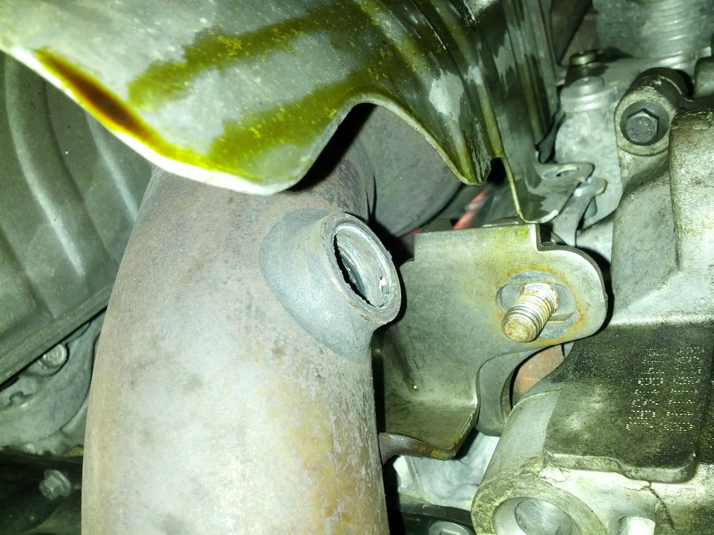

Thanks guys, after letting the PB Blaster soak overnight I went at it again in the morning. I ended up removing the clamp by hitting it with a hammer several times to loosen the binding and then I used a screwdriver to pry it open. The O2 sensor was a bit harder. I ended up running the car to heat up the down pipe and then using a 22mm open ended wrench instead of the socket. The wrench had a much better grip on the sensor. I'll be making sure I use anti seize on all those threads! Cheers!

Glad it worked out for you! Good idea on starting the car to heat it up. The threads on the downpipe don't look very good, or is that just a bit of dirt? Hopefully the sensor threads back in well for you!
By the way, a new clamp from Mini is only $13 Canadian or so, and comes with a new gasket as well - depending on what kind of shape your old gasket is in it may not hurt. Also, when you take the downpipe off, the two studs where the bracket on the downpipe attach to are mounted on brackets. If you reach above the studs, you'll find a bolt, I forget the size now, but loosening it makes it 1000x easier to get the downpipe past the studs on the turbo - believe me, I've done it 5 times between my friend's car and mine. I usually put everything back together, including the V band clamp, before I tighten them back up.

Cool, thanks for the tip. This whole process has given me a lesson in patience and working in small spaces!
