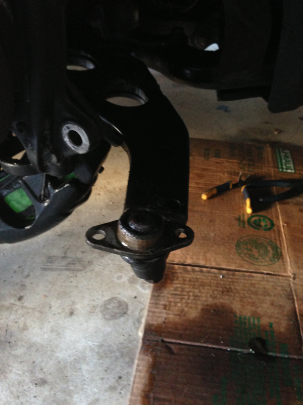

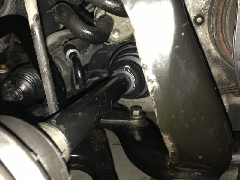

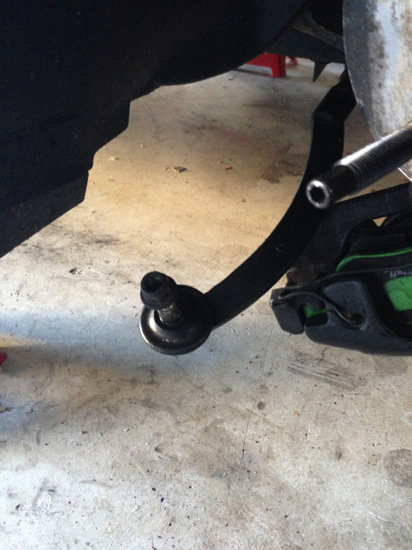

Just did this, forget the Bentley manual way it is way more complicated than it needs to be. Simply take off the axle nut, tie rod nut/bolt, and two bolts holding ball joint. Drop the arm off the ball joint and the entire hub assembly attached to the strut can now move out of the way after simply tapping the axle out of the hub. Now the entire axle pulls out of the cup at the tranny that the tripod joint (what's under in cv boot). Take it to the bench, pull off the c-clip and tap off tripod bearing. Remove and replace boot, grease the hell out of it and reassemble in reverse order.

That works, I just didn't want to have to be under the car trying to wrestle a boot on and bearing off. Simply removing the nut allows it to come right out and can do a bench job.
Some reference pics I had to help OP
