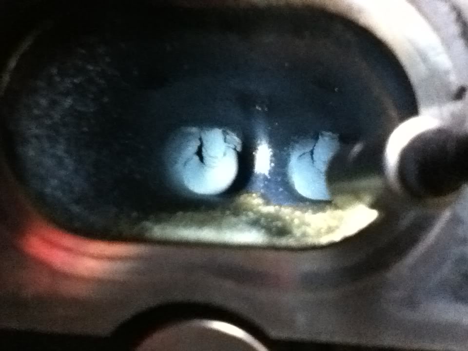

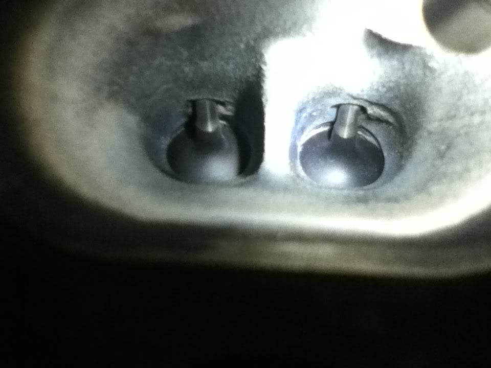

WOW. I had no idea my car had the power it does! Losing power slowly over time has caused me to not realize how much I had actually lost! When I started realizing that WOT pulls through gears wouldn't yield 1-2 or 2-3 chirps like I used to, and that my torque steer was gone, I figured it had something to do with tires... well, tonight, all that power is back. Haven't been pushed back into my seat like this since (who knows how long). Maybe never, since I've added more go fast parts since my initial tune.
What am I talking about? I realized that methanol was doing absolutely nothing to break up any carbon build up. In fact, soaking it in carb cleaner for 30 minutes yielded not much progress. It really relied on scraping and brushing with metal brushes/picks. Also, I knew I would be finding some build up when pulling the manifold today, but not like this:
One valve in Cyl 1 was the worst. I only had toothbrush style horiztonal bristles for my brass/steel brushes, and my nylon ones were the pipe cleaner like bristles. I wish I had those in metal, as cleaning the intake valve was the hardest, and the nylon brushes did not do much good. I ended up using a thin long flathead to lightly scrape the backsides of the intake valves and did my best. Resoaked them in carb cleaner again and did a final dry and spray.
Before:
After some scraping/soaking:
Finished. but could have done better with better tools. But I followed the 80/20 rule.. basically getting the last bits would only yield a small insignificant benefit compared to everything else thats been removed.
Example of some of the chunks coming off I was able to pick out, huge chunks would come flying out with intermittent air compressor blowing.

wow that looked terrible but looks like you did an amazing job cleaning it up. how many miles were on your car when you performed this and what were your driving habits like?
Lastly is there a write-up you followed to remove the intake manifold? is it easy to remove or will it take a long time (2+ hrs to remove).
Thanks for the photos.

How about we compare to a member who seafoams every 5k miles... compared to when he went to do the walnut blasting... He can chime in if he wants as well. (I believe he has right around the same mileage as me, 70ish-75k miles, its an '07, mines an '08)
CYL#1 Pre
CYL#1 Post
CYL#2 Pre
CYL#2 Post
CYL#3 Pre
CYL#3 Post
CYL#4 Pre
CYL#4 Post
Besides my Cyl 1 which was AWFUL, they don't look too much better than my Cyl 2-3 before I cleaned them. Also, this is a good comparison to show how much better a media blasting cleaning can be much more effective than manual scraping. Its evident I still have lots of carbon left on the valves, though compared to before, its magnitudes better.
No catch can, no PCV block, 70k miles. '08 S. Methanol for the last 10k miles.
Driving habits- No short drives, ever. Always let the car warm up to temp before getting into boost. During every drive, after it warms up to temp (I account for oil as well as water temp), I roll out the Revs at least once during the drive (WOT). So, imo, its the best scenario for clearing any deposits, but, again, this applies only so much to a DI car.
The problem with this myth that w/m will clean your valves is... w/m only sprays (for a short amount of time) when you are heavily on the throttle (depending on your injector duty cycle/boost setting for pump activation), which, isn't when you have the most oil blow by. The rest of the time, driving normally/cruising, and during warm up, there is no w/m to clean the valves.
The oil blow by occurs heavily when the car is cold, and the EGR is active (emissions control bs). Add it to oil thats not up to temp, doesn't flow well.
OCC and PCV block off are going in.
