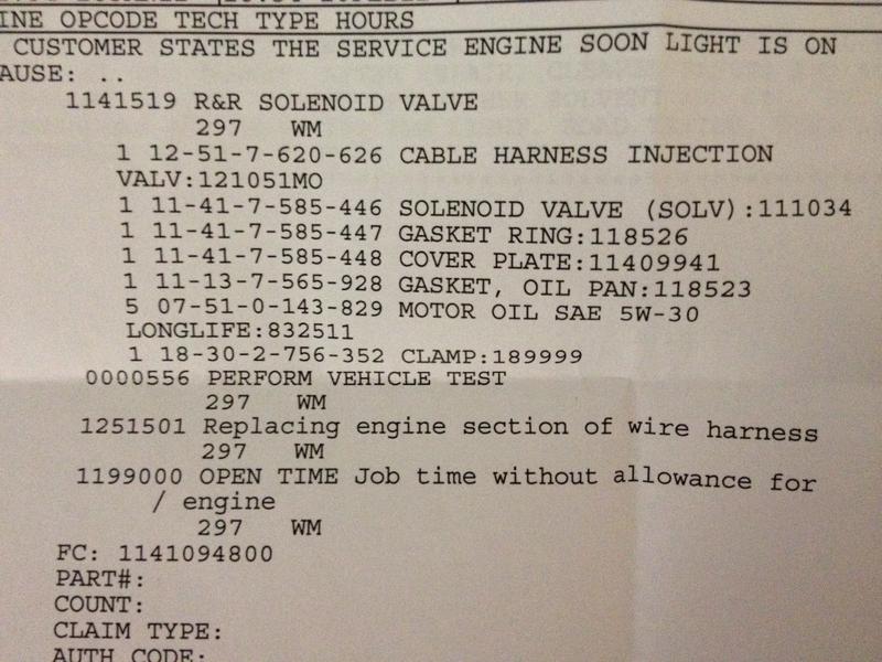

Ok, finally got my car back. Attached are two photos.
One is the service bill. It looks like it was the oil pan gasket that was leaking. The following text is at the bottom of the bill:
18700 leaking oil into engine harness wty - (diagnosis & repair) - performed vehicle test. dme stored faults (2c58 and 29dd: Charge air pressure and temp). performed test plan. per test plan, checked resistance of wires to charge air pressure sensor. two of the four wires were open. checked oil pump solenoid and found oil leaking through writing into the connector. wrote puma case (#50064105). per puma, replaced engine wire harness. r&r exhaust. replaced exhaust
Hope this isn't an issue for 2011s... :(
The other picture is a part I think is missing. Looks like something with the vacuum. Can someone with a 2011 take a picture of what their engine bay looks like?

Old Feb 10, 2012 | 06:54 PM
BAD69BIRD's Avatar
BAD69BIRD
Joined: May 2011
Posts: 14
nothing missing, earlier lc1 are blocked off later production there is a crankcase vent going to it

Old Feb 11, 2012 | 08:58 AM
nboprc's Avatar
nboprc
Joined: May 2011
Posts: 10
From: Iowa
theunclesam I have a 11 and I saw that nipple open and thought there was something missing but looked at another a the dealership and it is the same.

Old Feb 13, 2012 | 09:19 AM
BAD69BIRD's Avatar
BAD69BIRD
Joined: May 2011
Posts: 14
they did not remove them, they added them on later production models, sometimes parts changes happen before production changes so they just block things like that off
