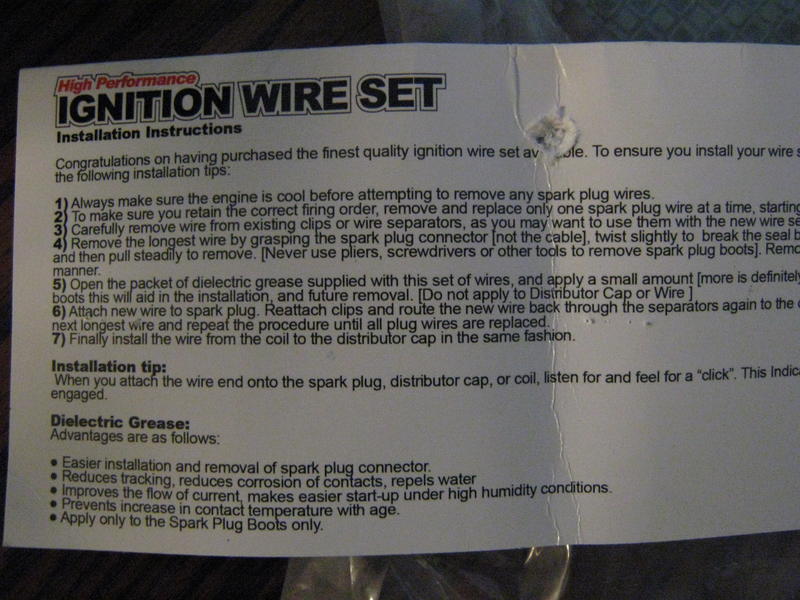

But I was under the impression that dialectric grease and alike was only to be used on the spark plug ends of these wires and not on the coil pack connections ?

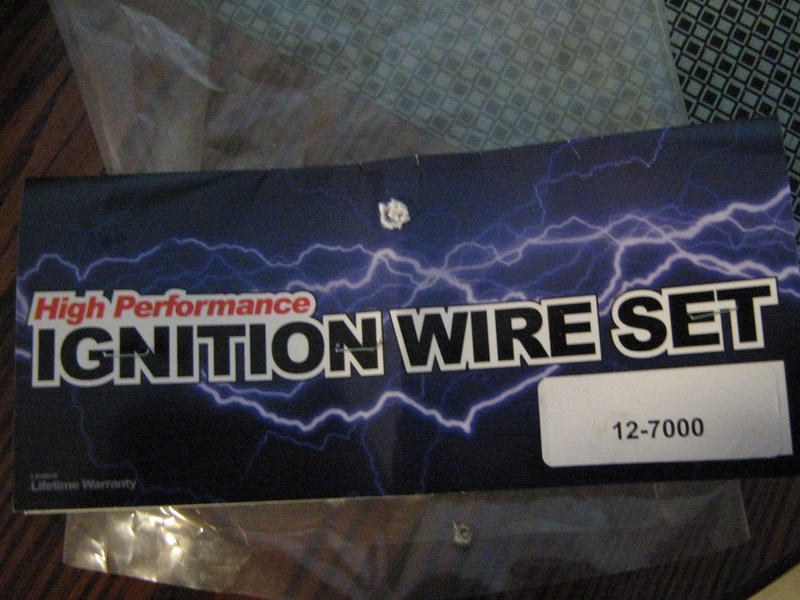

This is what I purchased.
But I can't find anywhere on the package as to who manufactured them ?

Any idea what brand wires these are Tim ?
They look like Walmart specials....
I went to Kingsborne web site. Seems odd they wouldn't put their own name on the package ?

Still would like to know who makes red wire set above ?

I think that is the oem kingsborne pack...no frils, but shows the lifetime warrenty..
i know mine were not in fancy "consumer" retail packaging, but pretty basic industry stuff... ut seemed like a good buy...in my case still is i think.
When i orded mine from the kingsborne website, they had color/ wire diameter options...i think the red was one option.
Attachment 55538
Attachment 55539
Yes that is Kingsborne packaging.
