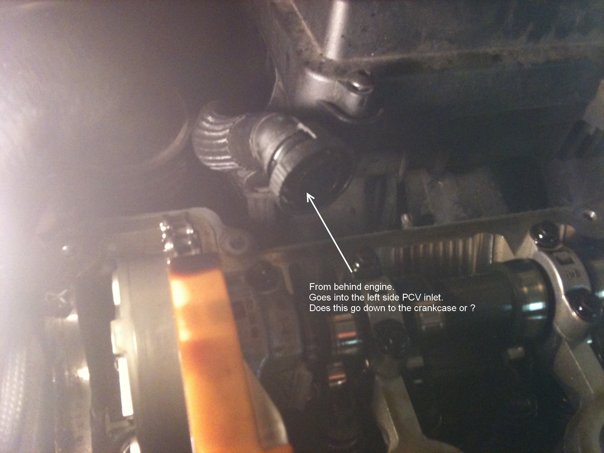

Hi all,
The local Mini dealer misread and overfilled the oil on my 07 Cooper S, and after I got home and checked the level I went back and had them drain off the excess. That was about 1 1/2 months ago and I have driven probably 1000 KM since.
I just noticed yesterday that my car was leaking oil, and after taking it back to the dealer they informed me that my PCV valve was shot and I needed to replace the complete valve cover because the PCV is not replaceable. They also said I need to replace my intake hose because the oil will degrade it over time. They quoted me 376.00 for the valve cover (Part # 11 12 7 585 907), 199.00 for the intake hose (Part # 13 71 7 555 784) and quoted about 2 hours labour, for a total of 900.00.
Because the car was 1 1/2 months out of warranty and they didin't want to help me I took it home and pulled off the valve cover and and cleaned out all the oil off the PCV to turbo intake hose, sensor and main intake hose, as well as a bit of oil on the turbo intake.
The valve cover seems to have a fair bit of oil inside the PCV valve, it almost seems like there's a puddle of it inside, and if I tilt the valve cover around I can drain off a bit of oil from inside the pcv inlets. The pipe that comes up from the left side of the engine(passenger side) and goes to the left pcv intake is oily as well.
Should that left side pipe be oily or would that be a result of overfilling? I think it should be, as it's probably connected to the crankcase somewhere on the back of the engine, so it'll get hot oily vapor sucked up from the crankcase. I am thinking if they overfilled it perhaps a bunch of oil got sucked up into the pcv valve and has gunked it up, and once it was gunked up started sucking it into the turbo intake.
If that's the case then maybe the pcv valve is just gummed up, and it looks like doing a few seafoam treatments may fix the problem. I sure don't want to dump close to a grand for what should be an easy fix. I also don't want to find out that I've just been suckered by the dealer.
Any and all response would be great.

I think I understand the whole PCV valve thing. The left side PCV inlet comes from the crankcase I think and needs vacuum, the right side goes to the turbo inlet and provides vacuum, and there's a one way orange valve inside the valve cover. That one has me a bit mystified because it seems like it would suck air into the valve train when there's vacuum in the upper engine, Maybe when Accelerating/ decelerating?
Hopefully the pictures will help make sense of this.

You obviously have a leak and you need to find the source of the leak. This is done by tracing the fluid trail from the bottom up, which is not always that easy. What exactly is pointing you towards your PCV line? Check where oil film is the thickest or puddled.

I checked the PCV valve and it seemed fairly blocked, so I tried to blow it out a bit with some air, and I seafoamed the crankcase and fuel. I could feel a bit of air coming through so it's not totally blocked, but I have no idea how restricted the pcv valve should be.
I also tightened the oil filter cover a bit. When I started the car it was dripping like crazy, and right below the oil filter cover. I looked around and I backed off the oil filler cover a bit in case it was too tight and tried again, and no leak! I went out for a drive and came back and still no leak and only a minimum amount of oily residue was in the right side pvc hose, and only on the end closest to the engine. There didn't seem to be any oil down by the turbo intake.
I think the "tech" (lot boy) who drained off the excess oil didn't bother undoing the oil plug on the oil pan, he just loosened off the oil filter cover and let some oil out. When he did it up it was either too tight or not tight enough and over time oil started seeping out, maybe only when the engine was cold? Once it warned up it expanded and sealed itself.
Time will tell. Right now it seems to run fine, there's no leak, and so far my repair costs are 10.00 for Seafoam.
I think I'm going to also get a catch can. They are not very expensive and I should have less oil vapours getting back into the intake, so the valves etc. should stay a bit cleaner.

This doesn't go anywhere near the crankcase, this goes into the inlet manifold. This pipe is now obsolete on the latest THP engines, and should be removed. This one pipe is the cause of most THP engine detonation under load and carbonization of the inlet valves!

I never did trace that pipe back. I thought it was a bit weird going back to the crankcase but with all the oil in it, it looked like that must be where it was going. It sounds like that oil was being sucked in through the valve cover by the sounds of it, and it would be better off plugged up. I'll have to look into it.
The dealership made a deal with me and all I ended up paying was 1 hours labour, they paid for the new valve cover.
The funny part is they left it out for me to pick up after they were closed, and when I went to pick it up there was an oil patch under it and when I started it, oil was leaking at a fairly steady rate. I would have made it a few miles before the engine would have been dry. I left it there with a note and they called me back on Monday to say the oil filter gasket was toast, and replaced it as well.
So it was the oil filter gasket leaking like I thought, and I think overfilling the oil sucked extra oil into the pcv valve and that caused the other problems. I think that's why the dealer did everything and only charged me labour.
