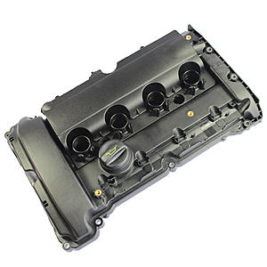

Has anyone had any luck with the ebay valve covers that sell for around $130? They seem decent quality... at least in the pics.
https://www.ebay.com/itm/New-Engine-...hZu-lR&vxp=mtr

those weren't on ebay when I bought mine. it has the same part number as the one on ecs. for brand is says JDMSPEED. it looks identical to the real thing looking at the pics
