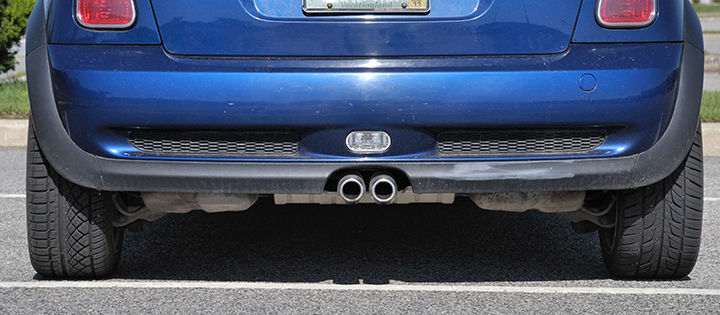

Here is that picture of the rear camber. The struts are fine, and everything is stock.

If you have a Droid phone download the bubble level app and check the camber. Place the phone on the wheel rim, not the tire as close the the centerline as possible. This is not very accurate, but at least you can get close. The pic does not look that bad.

You do not have much camber in the rear. Maybe -2.7 total (both sides combined). The rear camber looks normal.

Yeah it does not really look like -2.7. Tell the shop to go blank themselves and find another.

From that picture you have nothing close to -2.7, which is good news. Time for a second opinion from another alignment shop.

Looks ok.
Get another shop to check it for you.
Then, if it is within spec (or not as far out of spec as the first shop claimed) - file a complaint with the BBB.

Tire wear is usually a good indicator of tire alignment issues. Going by the tire wear in your picture, the right rear indicates some cupping, but the left looks to be wearing fairly even.
I would definately get a second opinion.
