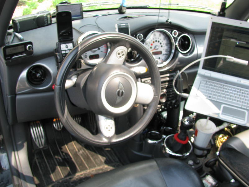

Its pretty much down to injectors now. Maybe a shot of ether in the intake would tell me something if it fires right up; no fuel! Correct, mostly highway miles, it is my office. All business during the week, all joy on the weekends.
Wow - your office indeed!
