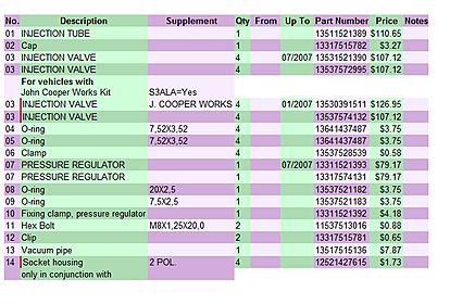

Mine is an 02 R53 right hand drive, coz i am in Hong Kong, so you may have a differ part number, check out this link:
http://www.realoem.com/bmw/showparts...&fg=15&lang=en
it is part no. 7 on the diagram
you can modifly the seacrh (with your car's VIN number)! and i am not sure the price for the parts in the table are in what currency, it costed me $1200 Hong Kong Dollars (include parts and labour), so roughly USD 150.
