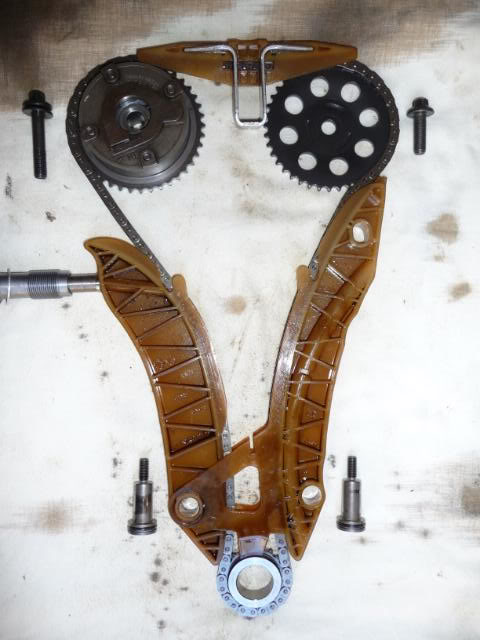

Problem repaired. It was indeed, as others surmised, the chain guide, as noted in the photos below.
I'd like to commend MINI for saving weight at the expense of durability. Brittle plastic next to a high speed-moving chain is a great combination; having little plastic pieces snagged by said chain and deposited into the dipstick shaft is even better!
My mechanic had a conversation with someone in an official MINI capacity (mechanic, service advisor, ?) and was told that this issue was addressed by a recall that only lasted until the 35k-mile mark. Strange, considering that the B-to-B warranty carries on until 50k. However, the source reiterated this fact and discrepancy.
He was also told that it's potentially a software issue, which has to do with the variable camshafts (is that the correct terminology?); if they're off-sync then it slackens/tightens the timing chain, placing undue stress on these cheap-*** plastic parts, causing the type of damage I experienced.
This I can't verify, but I was told that my motor got modified later in the model year? Mine's a March 2007 version with the turbo. Can't verify this.
The only saving grace is that my mechanic fixed this in 8.0, instead of the 14.0 as recommended in the Mitchell guide. He didn't have to drop the motor. This saved me quite a bundle.

Thanks for the update, MiniAmor. Nice to have some closure to this thread, even though the result sucks for you. I wish more people would post the resolution to the particular problem that caused them to post in the first place. Too many of these type of threads go on and on about the problem, but then just end with no mention of the solution.
Great photos and info from other members, too. Anyone who has a similar problem in the future will have a good reference in this thread.

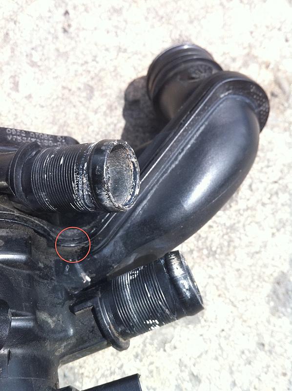

Oh, and as an added bonus, I had to replace my thermostat housing (see photo below; red circle is where the lower part of the housing warped, allowing fluid to spew out) along with the water pump. My mechanic was furious at the fact that the chain guide, water pump and thermostat housing were all made out of plastic.
