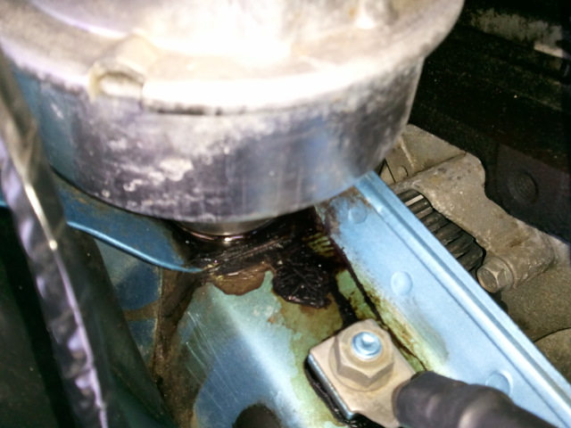

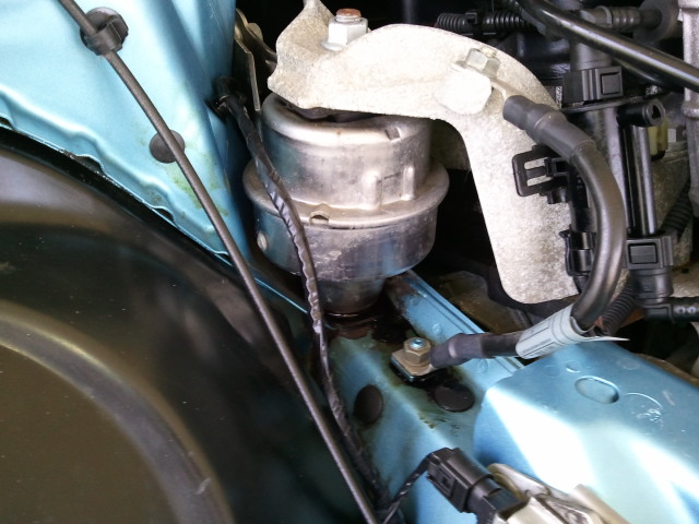

Seems that i may have a leak... Hard to fix? Should I be concerned? Just looks bad....

Not hard to fix, no damage, except the mess and NVH. This was a warranty issue, so the dealer may cover it if you're close to warranty mileage/time.

Easy to replace provided you have the correct Torx female socket, and a long extension.

Replace it with an aftermarket so you don't ever have to worry about it leaking again.

You can clean up the goo with rubbing alcohol ---

Normal problem, just need to replace the mount.

The one pictured is the upper mount. Call Way at waymotorworks, he'll take care of you.
