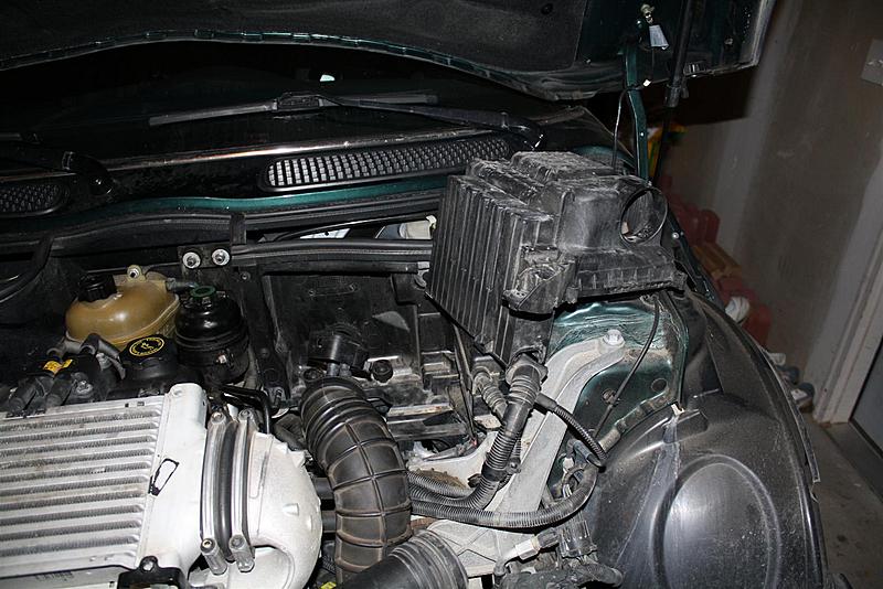

Remove the air box bottom
Remove the bolt right front corner of the air box bottom (one on the right in this picture).
The air box mounts with two rubber rings that are inserted into the back of the air box and these rings push onto two pins that stick up at the rear of the air box. Pull the air box bottom piece up at the front, pull forward to pull the box off the rubber mounts at the back, or lift up on the back to remove the rubber mounts from their pins. I pulled mine forward then collected the rubber rings from the pins and put them back into the air box bottom so I could simply push down to reinstall the bottom easily.
You should now be able to gain access to the thermostat, wiring and MAP sensor bracket and connectors.

Got it done. Yep, it was the thermostat gasket. I skipped steps above, here's how I did it.
I did not mess with the ECU. I simply swung the airbox out of the way. There is a picture above. Be careful so you don't nick wires.
I did this whole thing with the engine cold because I knew I was going to get intimate with it, I didn't want to burn myself.
I drained NO coolant. Do NOT touch the overflow tank. Make sure the cap is tight on. I took the thermostat off and the only coolant that dripped was whatever was in the housing. IF you mess with the overflow cap and open it, coolant will flush out because you will break vacuum.
I also did not disconnect the throttle body hose, I was able to work around it just fine.
So, if you skip the steps above I think you can get it done much faster and easier.
The old gasket looked terrible. There were at least 2 spots I was able to identify where it started leaking.
